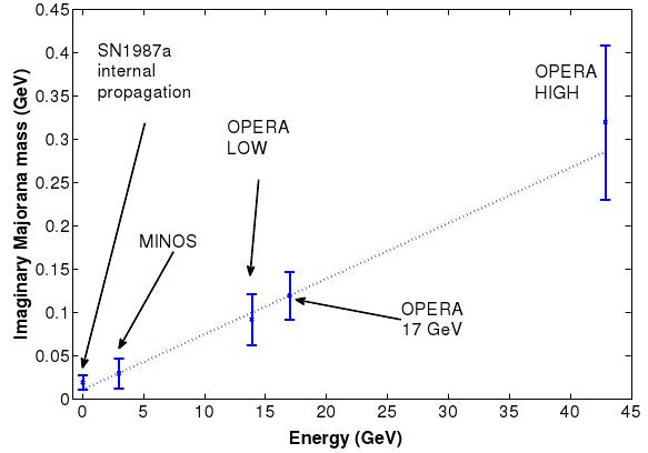

noego said:
To be honest, these news doesn't seem all that surprising to me. Even before this measurement, there was already a number of strange things concerning neutrinos which are not consistent with special relativity. To name two, the mass of neutrinos was measured to be non-zero, yet it seems they can travel long distances with the same ease light does.
According to SR, the speed of a particle is given by [itex]v(E) = c\sqrt{1-\frac{m^2 c^4}{E^2}}[/itex]. Any particle with very low mass and energy large enough to measure will necessarily travel at a speed very close to c.
The other one is that probable mass-square of neutrino was repeatedly measured to be negative. It's sad that it takes a sensation like this, to get the scientific community excited enough, to actually try and explain these discrepancies, while they are, at the core, all of the same nature.
Every previous experiment attempting to directly measure [itex]m^2[/itex] for individual neutrino states has had a result within [itex]2\sigma[/itex] of 0. A tendency toward null results could simply indicate a tendency of such experiments to slightly underestimate the neutrino energy (or overestimate its momentum). In any case, all such results are effectively null and really can't be expected to be taken as evidence for exotic neutrino properties.
