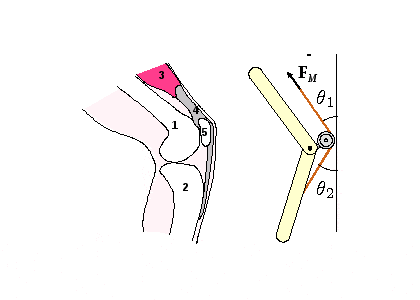

The diagram of the leg shows the femur (1) and tibia (2). The quadriceps muscle (3) applies a force to the lower leg via a tendon (4) that is embedded with the kneecap (5). If the force applied by the muscle to the tendon is FM = 420 N, what is the force of the femur on the kneecap? A simplified model of the leg is shown next to the diagram. The leg bones are represented by two beams attached by a pin. The tendon is modeled by a rope and the kneecap acts like a pulley. The tendon above the kneecap makes an angle θ1 = 23° with respect to the vertical, and the portion of the tendon below the kneecap makes an angle of θ2 = 24° with respect to the vertical. Enter the x component, followed by the y component.
https://www.physicsforums.com/attachment.php?attachmentid=51494&thumb=1&d=1349314642
fnet=ma
I tried:
Fnetx=max
T1x + T2x + Ffemurx = 0
-240sin23 + -240sin24 + Ffemurx= 0
-93.78 -97.62 + Ffemurx=0
Ffemurx= 191.4N
Fnety=may
T1y + T2y + Ffemury=0
240cos23 -240cos24 + Ffemury=0
220.92-219.25 + Ffemury=0
Ffemury=-1.67N
