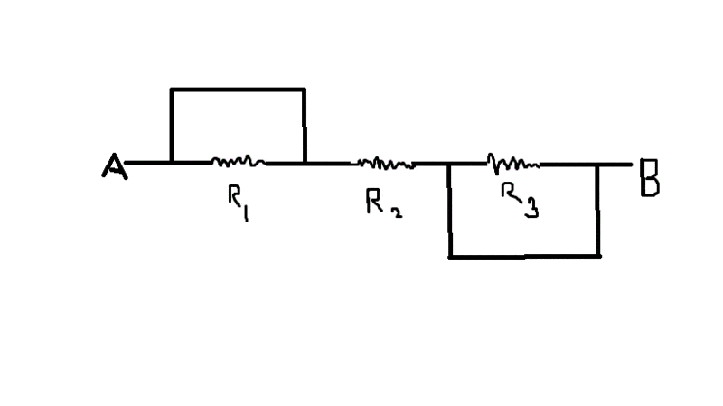

If a resistor shares common junctions to a conductor with no resistance in a circuit, will current flow through the resistor? Also, what is the equivalent resistance between A and B as in the figure...

If the wires were really perfect conductors with zero resistance, then there would be no voltage difference between the two ends of the resistor and therefore no current flow through the resistor.
In practice, no wire is a perfect conductor so there's always some tiny resistance and therefore some tiny voltage difference across the resistors to drive some tiny current flow through the resistor. However this current will be well and thoroughly negligible compared with the current through the wires (which will very quickly melt, burn, catch on fire, or explode if there's no fuse, internal resistance in the power supply, or some other current-limiting device).
if by the equivalent resistance you mean the total resistance it has with the junctions at both ends then the only resistance in your schematic is the one through "r2"

swap1996 said:
What is the equivalent resistance between A and B in this case...
Try redrawing that picture so that the resistors are side by side on your sheet of paper... You'll find that this makes the problem much easier.

Can you explain it properly, perhaps upload the diagram you are referring to...
Not until we've given you a few more hints... This problem is much easier than it looks... The end of every resistor in your diagram is connected directly to either point A or point B.
Even though this is not directly homework, you still need to show some effort here...
Since the left end of R1 is shorted to the right end of R2, just rotate R1 up and over clockwise 180 degrees to put it in parallel with R2. Then do a similar thing with R3 -- rotate it clockwise 180 degrees to put in in parallel with R2. What does the diagram look like now?
As Crazymechanic already pointed out, the equivalent resistance between A and B is R2 .
For the parallel portions of the circuit:
You can't use ##\displaystyle \ \frac{1}{R_\text{Parallel}}=\frac{1}{R_A}+\frac{1}{R_B} \,,\
## because one of the resistances is zero.
Instead, use ##\displaystyle \ R_\text{Parallel}=\frac{R_A\,R_B}{R_A+R_B} \ .##
