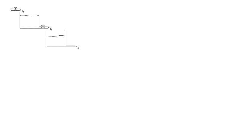

Hello!
I'm currently working on a project where i am supposed to model a two tank system. The only information the project gave me, was that i have to control the fluid level in tank 2 (what kind of fluid
is up to me). I have tried to put the problem in a practical contex, where i have imagined a simplified water treatment process.
Water flows into tank 1, which i control. I'm assuming tank1 is bigger than tank 2. And there is a valve on the "connection" between tank 1 and tank 2 that i control. The flow out of tank 2 is constant and i do not control it.
The problem:
1) I want to find the water flow in, that allows for the fluid level in tank 2 to be constant, even with constant flow out.
2) Also, as a second problem, i want to simulate som disturbances in the water flow in, so that i am forced to use the water in tank 1 as a buffer (the goal is still to maintain a constant level in tank 2, while constant flow out)
Could someone help me/help get me started? Kinda new to this way of thinking, and I am finding it somewhat difficult.
Thanks in advance!
EDIT: fixed attached picture
Am I missing something? To keep the level in tank 2 constant, set the flow in from tank 1 equal to the flow out of tank 2.
I may have done a poor job of formulating my problem , sorry about that. I'm going to sit down and think this through, i see your point, its actually pretty simple :P

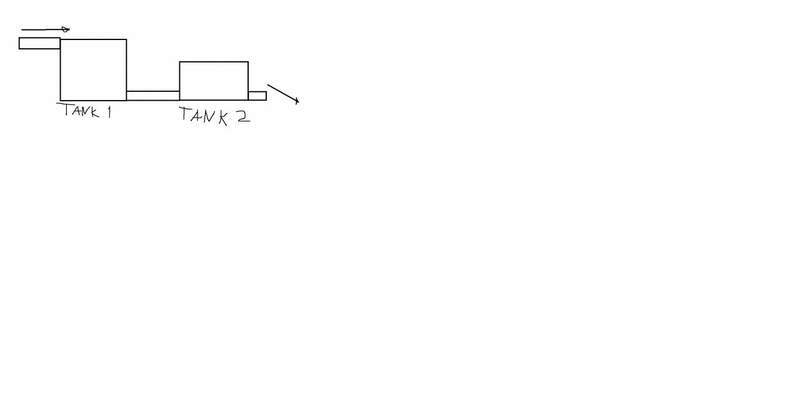

Thanks for the replies, and sorry for not answering, have been quite busy with the project. I have coupled the tanks a bit different, and the result was a second order system. I am struggling with findint the damping, and the gain of the system, based on the following equations:
dH1/dt=(1/(PA1)*(f_in-R1(H1-H2)
dH2/dt=(1/(PA2)*(R1(H1-H2)-(R2*H2)
R1, R2, 1/PA1 and 1/PA2 are just constants. f_in flows into the top of tank 1.
I'm not sure if I've bit of more than i can chew, I've found a approximation of the time constant simply by looking at the graph, but any help with the damping and gain would be appreciated :)
