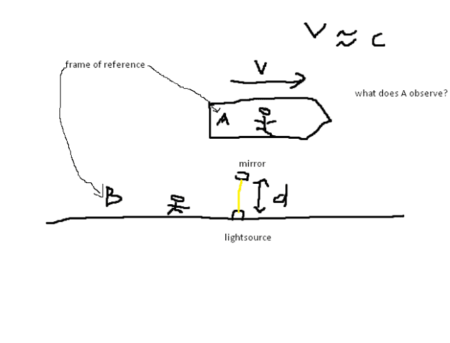

So I was reading the proof of time dilation. It explains how the observer in a rest frame observes a longer path of the light than the observer in the moving frame.
However, I made a drawing of a slightly different experiment, where I can't predict the result of it. I was hoping somebody could help me out. In the picture below, the person in frame of reference A is moving close to the light speed. In the rest frame an observer is sending light between two vertical points as shown in the picture. The person in the rest frame would see that the light goes between the two points in time t determined by the given distance d and velocity c. Now, I am wondering what would the person in frame of reference A observe? If time is really slower for him, he would have to observe a shorter path with the same speed. However as far as I can see, the c and d variables is the same for the people in both frame of references giving equal time? I hope somebody can help me out with my confusion here, thanks a lot :)
In A's rest frame, the mirrors are moving, so the light going from the top mirror to the bottom is going "diagonally". The distance between the mirrors is the same in both frames. Light going from the top mirror to the bottom travels a distance d=ct in B's frame, and ct' in A's frame (where t' is the time measured by A). The pythagoran theorem tells us that ##(ct')^2=(ct)^2+(vt')^2##. Solve this for t, and you get
$$t=\frac{t'}{\sqrt{1-\frac{v^2}{c^2}}}=\gamma t'.$$.

Yes I thought about this too. But the result seems strange to me, because it now predicts that time goes slower in the rest frame and not in the moving frame, just because we changed the location of the experiment.
For example if we had done the experiment in frame A instead of B, t and t' would change place in the equation predicting opposite results, as such:
$$t'=\frac{t}{\sqrt{1-\frac{v^2}{c^2}}}.$$.
How is this possible?
It's possible because t and t' mean different things in the two equalities. Consider two inertial coordinate systems S and S' with a common origin. Denote the velocity of S' in S by v. We assume that v>0. Denote the event at the origin by O. Let E be an event on the time axis of S, and denote the time coordinate of E in S by t. Now the time dilation formula tells us that t'=γt. Here t' is the time coordinate of E in S'. Note that E is not on the time axis of S'.
But when you use the time dilation formula to go from S' to S instead, t' is the time coordinate of an event F on the time axis of S', and t is the time coordinate of F in S. So we're not just doing the calculation we did before "in reverse". It's a calculation that involves a different event.

According to Special Relativity, time does not go slower in any rest frame you choose, it only goes slower for objects/observers/clocks that are moving in any rest frame you choose. It's no different than saying that the rocket is moving in the ground's rest frame and the ground is moving in the rocket's rest frame. How is that possible?
But it does help to consider that in the ground's rest frame, the clock on the rocket is ticking slower and it is moving away from the clock on the ground. So between each tick of the rocket clock, as it observes the ground clock, it has moved farther away and so the image of the ground clock's ticks have farther to travel resulting in a longer time compared to its own ticks. It turns out that the ratio of the ground clock's tick interval compared to the rocket clock's tick interval as determined by the rocket is the same as the ratio of the rocket clock's tick interval compared to the ground clock's tick as determined by the ground. Work it out, you'll see that this is true.

To observer A, the light clock on the ground is moving past him, so as far as he’s concerned the light which leaves the source and reaches the mirror hasn’t just covered distance d in the vertical direction – it must appear to follow a diagonal path, which, therefore, is longer than d. Since, as you rightly say, all observers measure light to travel at velocity c, A must conclude that the light has had to take longer to go from the source to the mirror than if the clock were stationary in his own frame. So A concludes, from observing B’s light clock, that time must be running slower in B’s frame than his own.
So why does observer B say that time in A’s frame is running slower? Suppose A had an identical light clock on his ship. He would observe the light moving a vertical distance d, in his frame, from the source to the mirror. But B would observe, because of the relative motion of the ship, the light tracing a diagonal path. This path would be longer than d, leading B to conclude that, since the light, traveling at velocity c, takes longer to cover this diagonal distance than it would take to travel the just the vertical distance d, time on the ship must be running slower than time on the ground.

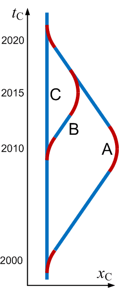

And what if both decide to return and then meet halfway?
I think my aging process will not change if someone runs away from me.
Then they'll be the same age when they meet.

I don't think I said anything that can be interpreted that way. If A and B both leave Earth, going at the same speed in opposite directions, and after a while turn around and go back, they'll be the same age when they meet. If instead A stays here while B leaves and later comes back, B will be younger when they meet.
In the scenario that you describe now, where B goes from Earth to some distant location and stays there, and A makes the same journey some time later, then they will certainly be the same age when they meet.

No, it's the speed, not the acceleration. The following spacetime diagram, made by DrGreg, following a description by yuiop, illustrates this point.
Here the twins are doing exactly the same acceleration, but spend different amounts of time at the higher speed relative to Earth. The one who spent the most time at the higher speed ends up being younger when they're both back on Earth.
The intent of this phrasing is admirable, but can lead to errors if taken too seriously. In fact, I conclude no simple, intuitive statement about which twin ages less can cover all cases, even in SR:
