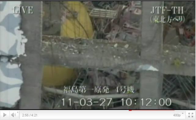

by looking at another video from NHK, we see the collapsed roof of R1 and I realized that the red beams are actually horizontal.
(http://www3.nhk.or.jp/daily/english/25_30.html , around the 3/5th)
So I repost the screenshot of the first video in a better orientation
[PLAIN]http://www-laog.obs.ujf-grenoble.fr/~henri/Fukushima2.gif
still difficult to decide what it is - but it may be a glowing light through a crack of the collapsed roof. If the reactor vessel is damaged, it has been probably during the explosion, or it may be a glow from the SFP.
