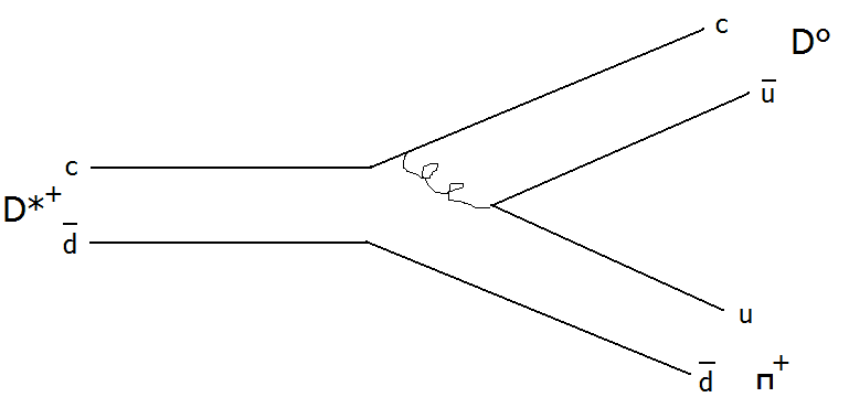

Diagrams like this are common QCD decay modes and I think they match the description of Herbascious J.
And the hadronization after hadron collisions has those processes everywhere.
