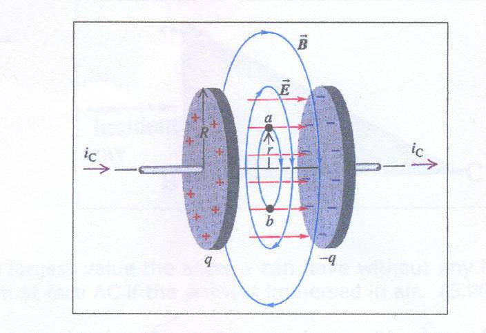

A parallel plate air-filled capacitor is being charged as in figure. The circular plates have a radius of 4.0 cm, and at a particular instant the conduction current in the wires is .280 A.
A. What is the displacement current density (jD) in the air space between the plates?
B. What is the rate at which the electric field between the plates is changing?
C. What is the induced magnetic field between the plates at a distance of 2.0 cm from the axis?
D. What is the induced magnetic field between the plates at a distance of 1.0 cm from the axis?
an image is attached
This is my solution as is...

answer a is correct but b, c, and d are not. I have tried this multiple times and can't figure out where I am going wrong. Any help would be appreciated.

Your exponent for part b is wrong... it should be +12.
I don't understand how you're doing c and d. Did you try to apply Ampere's law? Can you show the details?
You should use the conduction current + displacement current.
Also for part b), the equation should be:
[tex]\frac{d\phi}{dt}=\frac{jD}{\epsilon}[/tex]
[tex]\frac{d(EA)}{dt}=\frac{jD}{\epsilon}[/tex]
[tex]A\frac{dE}{dt}=\frac{jD}{\epsilon}[/tex]
You know the area [tex]\pi{R}^2[/tex] where R = 0.04m, so you can calculate dE/dt.
correction: using B= (uo id/2piR^2) r
to find induced magnetic field inside a circular capacitor.
uo=mu
id=displacement current
pi=3.14
R^2= radius of plate squared
r= radius from center (point inside capacitor)
I have values
uo=1.256810^-6 (permeability constant)
id= .280
R= 4 cm
r(c)= 2cm
r(d)= 1 cm
plugging in the given values i get
part c= 7*10^-9
part d= 3.5*10^-9
does this look correct?
