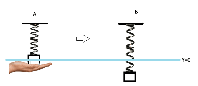

At first glance, I can't seem to figure out what is wrong with the argument. So I began recreating the whole thing.
I started drawing it this way:
A is the intial situation where the spring is at rest, not supporting the mass. It's just there.
B is the situation where the mass has been attached to the spring which supports the mass' weight. The blue line depicts y=0.
Since no non-conservative forces seem to be involved here, I applied the conservation of total mechanical energy, this makes:
EA=EB
KA+UA=KB+UB
Since the A situation is at the assigned zero, both elastic potential and gravitational potential will be 0. It's at rest so kinetic is also 0. In short, EA=0
0=1/2 cy2 - mgy + 1/2 mv2
The spring would go up and down and eventually reach equilibrium, where the kinetic energy is zero.
0=1/2 cy2 - mgy
So far nothing wrong has been found about the problem given. Because this leads to:
mgy=1/2 cy2
And then, solving for y, it becomes
y= (2mg)/C
Again, this matches the results given. So I can't find what's wrong. Is it a trick question and nothing is wrong? Am I missing something? Thanks!

The 'paradox' part is now to consider forces on the balanced mass. The spring exerts a force of cy upwards. Gravity exerts a force of mg downwards. If you put y=(2mg)/c then you conclude the spring exerts a force of 2mg upwards. The forces don't balance. Paradox!
*slaps forehead* I should have seen that. O_O
The paradox is clear now. What's not clear is how did this happen. There are no other forces acting on it. That 2 shouldn't be there. I'm beyond exhausted, going to have to sleep on it. Thank you very much! (It seems weird to say 'thank you very much, Dick', but yeah. Thank you.)

Oh wait. If... there are no other forces, wouldn't it oscillate instead of just sitting there? When you release the mass, realistically it would go beyond the equilibrium point then back up, and keep oscillating. I assumed that 'eventually', it would stop moving. But that's only because in reality, oscillators are damped. By friction, usually. So the paradox happens because this system is not really free from non-conservative forces?
You've got it. It will just oscillate if something is not damping it. If something is damping it, it will stop at the force equilibrium point. Now you can sleep without disturbing dreams.
