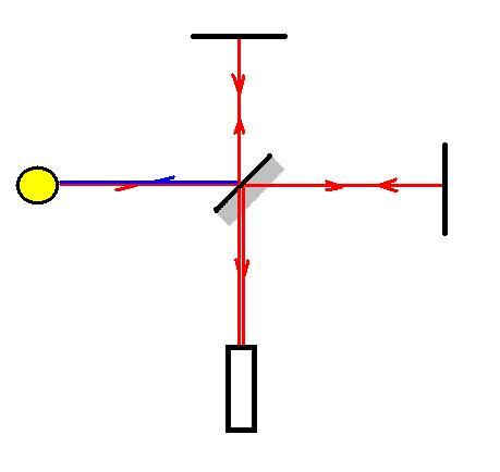

I think I partly get what the OP means. We should look at the problem a little bit theoretically for simplicity. I'll share my opinion, though I'm not sure about it.
See the figure (there should be another transparent plate placed parallel to the half-silvered mirror, but I forgot to draw it :tongue:). Consider a particular ray from the source. The ray is divided into halves, each of which then comes to and is reflected by the mirrors. The reflected rays from the 2 mirrors don't all head to the detector. Instead, when they come to the half-silvered mirror, each ray, again, is halved: one heads to the detector (red ray) and one heads back to the source (blue ray). We can see that the light path difference of the blue rays is half wavelength different from the light path difference of the red rays heading towards the detector. That means, when the detector detects a destructive pattern, the source receives back a constructive signal, and vice versa. The energy, as always, is conserved.
