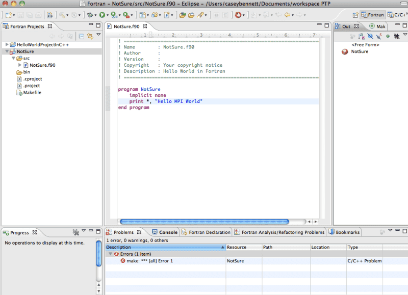

Alrighty then :smile: So in order to solve a problem in a previous thread, I simply reinstalled Eclipse, but this time i went with the Parallel Tools Platform since it is supposed to work with FOTRAN too.
I created a C++ project first and did the 'Hello World' thing to make sure it was working. C++ is working fine as far as I can tell.
So I switched to a FORTRAN project and I am having trouble Building. I have a screenshot below. Perhaps someone can help me out with what this might mean? I am used to using Digital Fortran (yeah, I know--old as dinosaurs) where I simply write code, build and run.

EDIT: I think I should include some more details:
I am using a Mac OS = Snow Leopard.
The exact steps I used to generate the error in the screenshot above:
1) Right-click in Package Explorer: New -> FORRAN Project ->Makefile Project ->Demo Hello World FORTRAN
2) Attempt to Build the source code that was generated by the Hello World Project creation.
*Note:
a) I don't know why I use the 'Makefile' projects, I just saw it in a tutorial. Can someone enlighten me?
b) When I select the Makefile project, there are options in the 'Toolchains' window. I think this might be related to my problem: When the box that says "Show project types and toolchains only if they are supported on the platform" is checked I only see the XLF Tool Chain. But if I uncheck it, I can see GCC Fortran. (See new screen shots below). Selecting the GCC Fortran does not help resolve the issue, but it raises my question of why does is it NOT available when the box IS checked?
With Box checked:
With Box Unchecked:

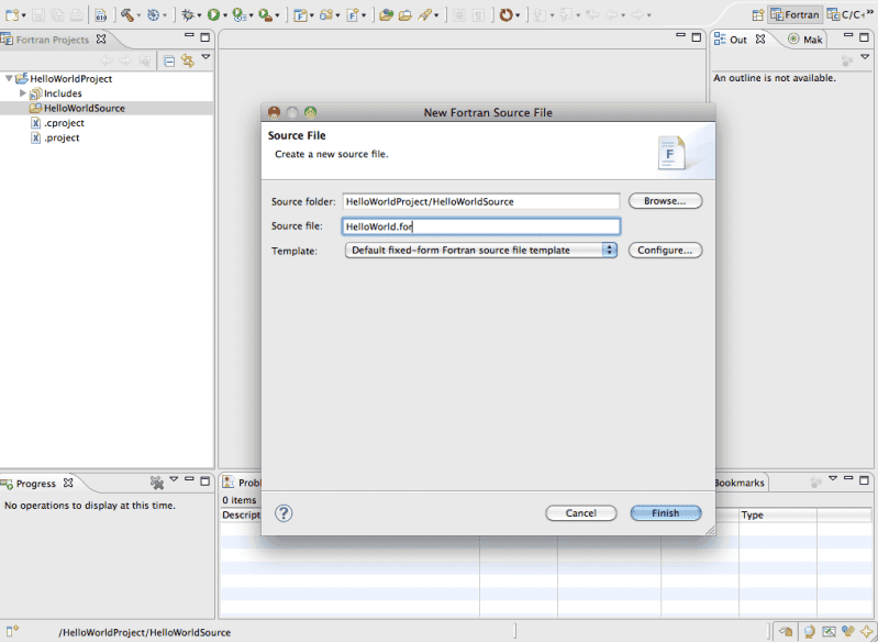

So if I follow these steps:
1) New -> Fortran Project -> Executable (Gnu Fortran on MacOS X)
2) In the Project: New -> source folder
3) In Source folder: New -> Named HelloWorld1.for -> Select from dropdown: fixed form template
Upon running a simple Hello World I get the following screen. Here is what is bothering me:
a) The source folder icon named HelloWorld1 in the package explorer on the left has a little superscripted "C" on it whereas the project folder icon has a superscripted "F". So I think Eclpipse is thinking this is C or something.
b) In the error window there is the C/C++ thing under 'type' which makes me think the same.

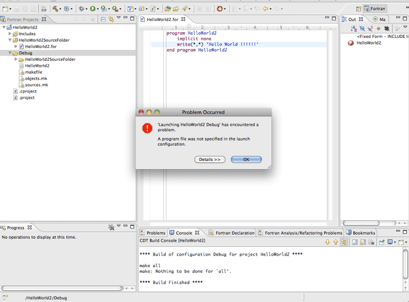

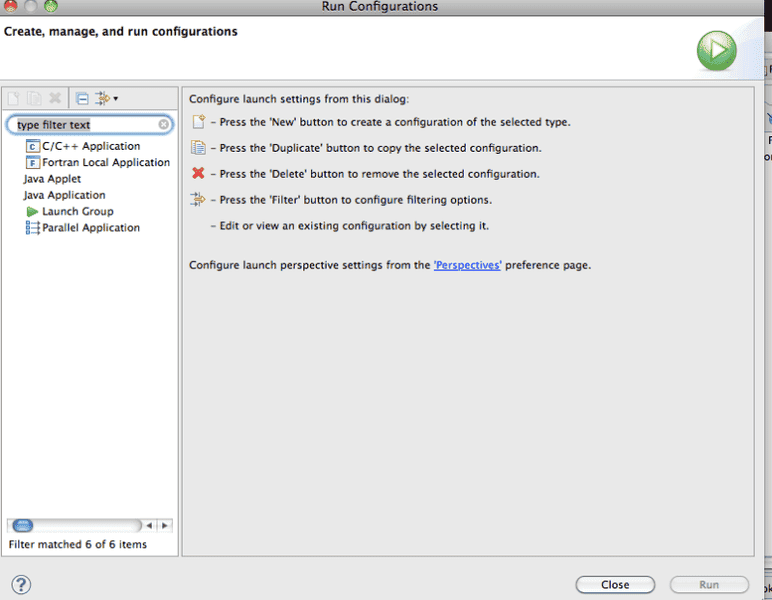

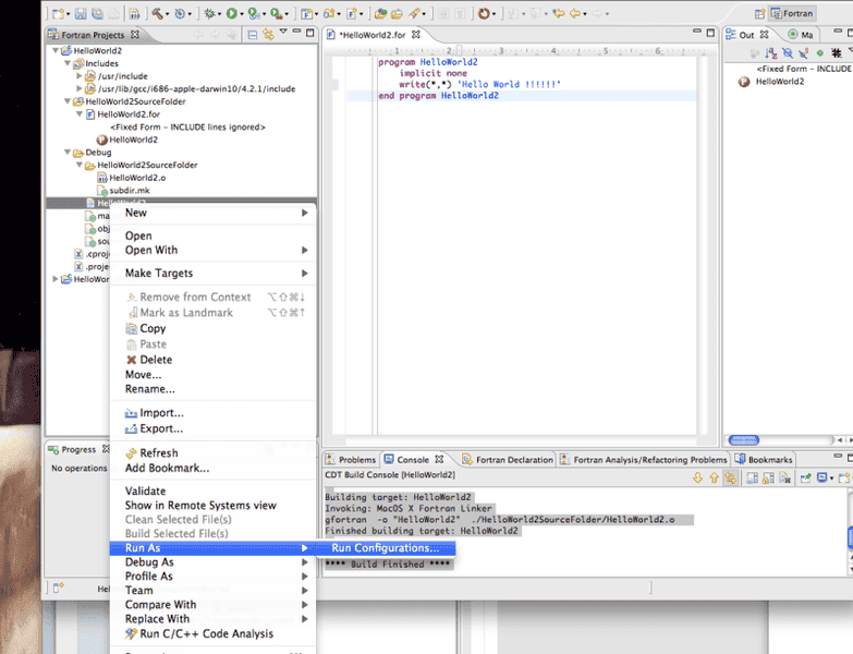

Okay! That got the symbolic link made. I went back into Eclipse and the Source code Builds successfully without errors/warnings. BUT, when I click: Run ->Run As Local Fortran App I get the error:
Launch Failed: Binary Not Found.
I feel like we are almost there! But without a non-generic error message, I am not sure what the next step is.
Thanks for all of your time and patience so far ILS!
Check in the Console tab-sheet which executable binary was generated.
Check if you can run it from a terminal window.
You run it with something like:
$ ./HelloWorld1

OMG. I am really starting to dislike Eclipse. Why would it build 'HelloWorldProjectInC++' when my active window is the source code in my Fortran project? Anywho: After Clean/Build, this is what I get:
Code:
**** Build of configuration Debug for project HelloWorld2 ****
make all
Building file: ../HelloWorld2SourceFolder/HelloWorld2.for
Invoking: GNU Fortran Compiler
gfortran -funderscoring -O0 -g -Wall -c -fmessage-length=0 -o "HelloWorld2SourceFolder/HelloWorld2.o" "../HelloWorld2SourceFolder/HelloWorld2.for"
Finished building: ../HelloWorld2SourceFolder/HelloWorld2.for
Building target: HelloWorld2
Invoking: MacOS X Fortran Linker
gfortran  -o "HelloWorld2"  ./HelloWorld2SourceFolder/HelloWorld2.o
Finished building target: HelloWorld2
**** Build Finished ****
I still get the Binary Not Found error when I try to run it. :cry:

Check the project explorer window in Eclipse (the left window).
In the Debug directory you should be able to find the binary HelloWorld2.
Right-click it and select Run.
If you can't find it, right-click Debug and select Refresh first.
  • #33
I don't seem to have any Binaries (And hence the Error). This is all I have (refreshing does not improve):
  • #34
Do you see the document "HelloWorld2" in the Debug folder?
Try right-clicking that...
  • #35
Jeesh. I right click that and I can choose 'Run As' -> Run Configurations
which brings me to the following screen:
I am not sure where to go from here. Everything is prefilled with the C++ project stuff. I don't understand why. I am clearly right clicking on the HelloWOrld2 bin which is in the fortran project.
