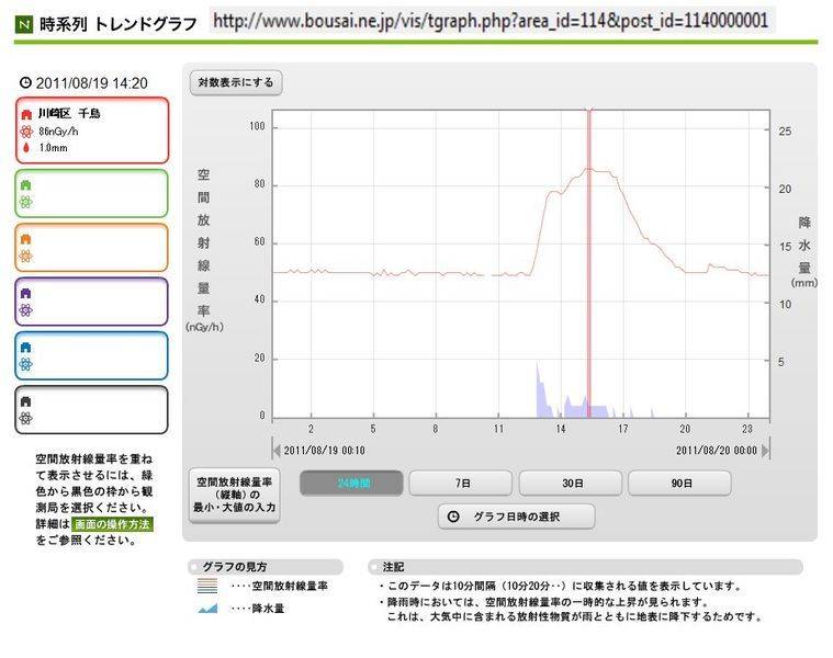

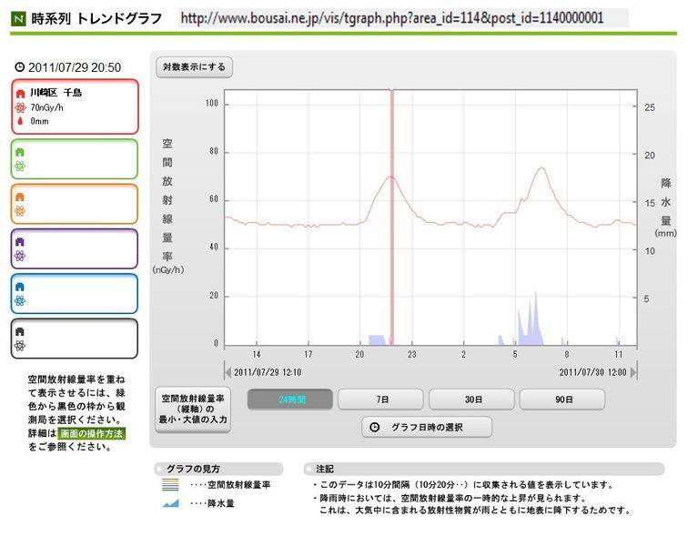

Jim Lagerfeld said:
North winds and rain for the first time in quite a while in Tokyo, while we were all out enjoying the a break from the heatwave, environmental radiation clearly spiked during the short rain storm - from o.o65 to 0.01 uSv in Kawasaki, 0.058 to 0.093 in Saitama city. You can see it very clearly here: http://guregoro.sakura.ne.jp/radioactivity/kanagawa/ [Broken] and a screen grab here
data is taken from official prefectural monitoring stations.
Yes, I had noticed this in another location which was also downwind of Fukushima Daiichi and raining heavily that day. Two questions, for anyone who knows:
1) Why did the levels drop again after the rain stopped? If it was Cesium being brought down, should it not have remained on the ground and raised the background level permanently afterwards (as happened in the March bursts in several places)? But it doesn't, it drops back to the previous level after the rain stops. Why the difference this time from the spikes in March?
2) What does this imply about the ongoing level of atmospheric emissions from the plant?
If there's radon in the soil (I don't know what the situation is in Japan), one explanation for external radiation peaks during and briefly after heavy rainfall could be wash-down of short-lived daughters on Rn-222: http://www.hps.org/publicinformation/ate/q1241.html [Broken]
Thank you. Interesting. I had no idea.
So the wind coming from Fukushima Daiichi would have been just a coincidence, if this was the cause. (Or... could radon created by uranium decay in the melted/damaged fuel have been blown over? Would that even make sense?)
