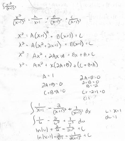

Integrate using Partial Fractions

Your coefficients are correct, so no problem there. Just a little issue, but [tex] du = dx [/tex] not [tex] du = 1[/tex].
Other than that, there is no error. Your solution is correct.
Oh, ok thanks.
