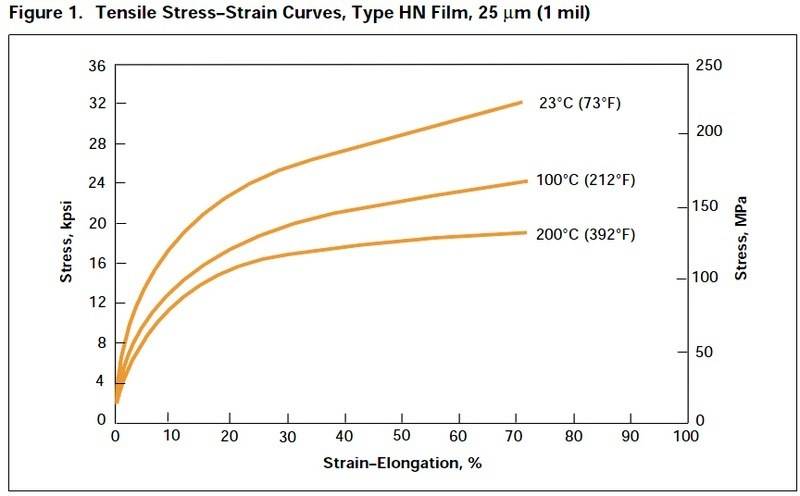

I´m considering plastic materials like this one:
- DuPont´s Kapton Polyimide Film 25 μm (1 mil) type HN .
Density: 1.42 g/ml
Tensile strength at 5% elongation: 90 MPa
tensile strength at break: 231 MPa (82% elongation)
Poisson ratio: 0.34
Tensile modulus: 2.5 GPa
(the tensile Stress–Strain curve is attached in this post).
So, beyond 5% strain, your material is no longer elastic? Your plots are showing 70% strain, so I assume that is mostly plastic behavior. The Mooney Rivlin model is an elastic model.
Are you asking if you can simulate the response of some structure composed of this material (thin membrane, as you say) using a Mooney-Rivlin model that is characterized from the tensile-test data that you attached? I don't think that would be accurate at all. You need to use some kind of damage model.
You might consider something simpler, like a steel model with plasticity. I would bet that such a model would give better results than any hyperelastic model, if you are well beyond the elastic limit of your material.

After posting I found that yield strain for Kapton HN is around 3%, so as you´ve pointed out, it is not within the elastic range at all. Sorry, I wrongly thought that the material would go back to its initial shape after such a large strain (≈70%).

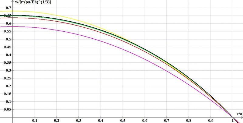

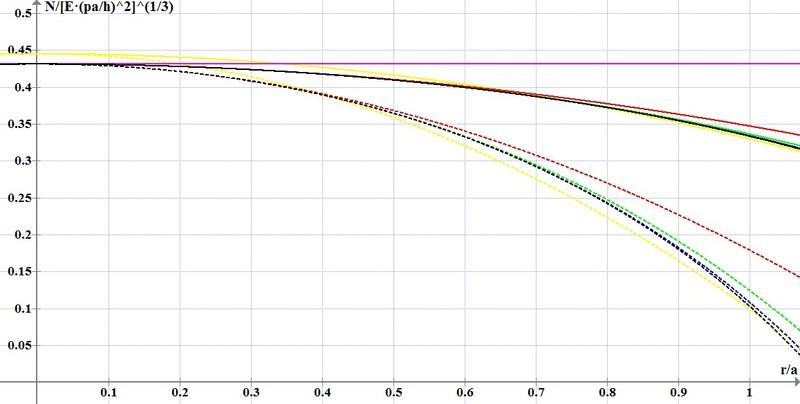

I used Henky´s equations to compute and plot circunferential and meridional stresses and strains. I will share with you the plots in my next post. (I´m not at my computer know)

The problem of using Henky´s formulation (and related ones: Fischer´s [2]) is that it considers the material as Hookean, but the stress-strain curve shown above is far from it. Do you know any book or paper dealing with plastic clamped thin membranes in the large deformation range? There must exist some engieneering analytic approach for this...
Besides Hencky´s formulas, I´ve found a recent (2008) paper from Zhao [3] with simpler equations for the stresses, strains and deflections of thin circular membranes. Although both approaches are very similar and their behavior is non-linear, they are not intended for plastic materials (only the Young´s modulus and the Poisson ratio are the linear material properties).
I´ve prepared and attached two plots with the comparison here:
Hencky_N: Hencky´s thin circular membrane adimensional stresses as a function of the adimensional radius (r/a) obtained by truncating the series in n = 0, 2, 4, 6 y 8 (purple, red, green, blue and black, respectively). Meridional and circunferential components are shown as full or broken lines, respectively. Zhao´s results are shown with yellow lines.
Hencky_W: Hencky´s and Zhao´s adimensional deflection as a function of the adimensional radius. The previous color scheme was used here again.
