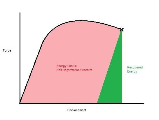

I'm beginning to think that just looking at the force/displacement curves for breaking a bolt will tell me everything I need to know. The area under the curve is the energy put into the system. For example, looking at this force/displacement curve:
If you almost reach the point of fracture, but let off the force, you will recover based on the elastic modulus. The rest of the area was energy wasted in plastically deforming the bolt. So, that leads me to think that once fracture occurs, the energy (green) is available for conversion from potential to kinetic.
That is the only thing that makes sense to me right now, without getting into fracture mechanics. But, I could be totally wrong.
For what it is worth I agree with your description. Note that the area of the green section is indeed the expression I gave earlier with F being the ultimate tensile strength, that is, the expression effectively "ignores" any energy lost due to plastic deformation.
That's right. The only energy you can recover is from the elastic strain energy in the bolt. You already used the plastic strain energy in stretching the bolt permanently. You can't use it again.
I think the estimate of 34 m/s velociity is a bit high. You didn't state what you assumed for the mass of the broken piece (don't forget the bolt head, for example). Some energy will go into vibrations in the bolt and the flanges, as well as the "rigid body" motion of the bolt. But broken bolts can certainly "fly" a long way if they get "launched" cleanly, without catching on the side of the bolt holes etc.
