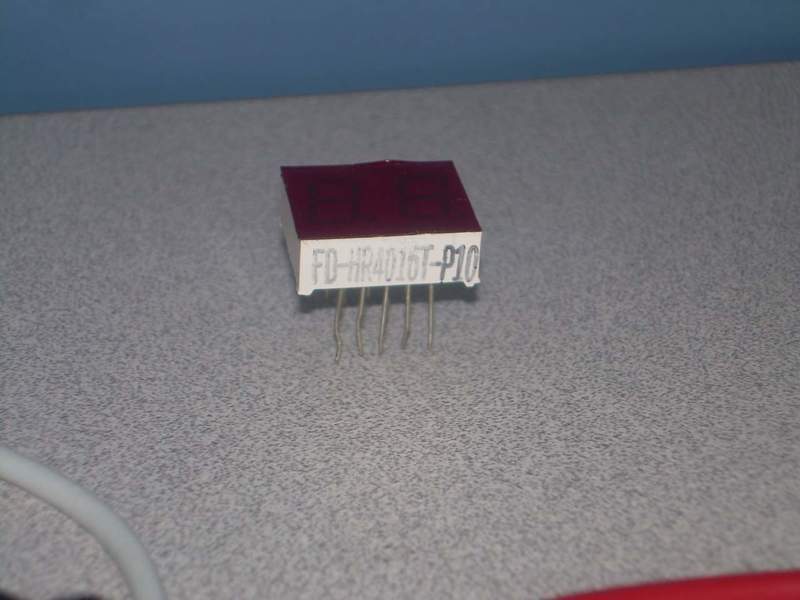

Hey Guys,
So I was scrapping parts from an ancient present I found up in the attic called the "Singing Machine". Point is I managed to retrieve a dual 7 segment display. The only documentation I can find online is for 14 pin versions of these things. Strangely this only has 10 pins and I can assure you none broke off. Anyone have any idea what these pins match to?

It should be pretty simple to figure out. Put a 10K resistor on a 5-15V power supply, then in a darkened room touch the leads to different pairs of pins. Once you know what's what, crank the current up for reasonable brightness.
I kinda expected to get that answer. I have been playing around with the pins for about 2 hours now but most of them seem to be multiplexed.
Can you post a picture? Are there any markings on it?
Picture is attached
Interesting. Googling the part number doesn't turn up anything helpful (but you knew that already). To drive two sets of seven segments takes at least 9 pins if you share the segments and just have two different common cathodes or common anodes per digit.
You said you did some beeping -- were you able to identify a CC or CA or two?
The strange thing is this was used for a track number display for a CD so both 7 seg's must have been controlled differently. Pin 7 when + turns on the right screen and Pin 8 + turns on the left screen. When both are + both screens go on. Whenever I change the other pins they change both screens so I am confused as to how to change each screen individually. Pin 2 when - is the d.p. Each Pin is an annode because it is only affected when in the - side. I believe I am describing this correctly. Sorry I am not very familiar with describing it other ways.

So it sounds like each digit is configured with a common cathode (- side), with the two CC pins providing multiplex access to the digits. Each of the pairs of 7 segments share an anode pin. So your drive circuit will need to drive the two digits in an alternating fashion, with each digit being on for 1/2 of the time. Drive them above the flicker fusion frequency of the human eye -- something like 50Hz should be fast enough, but you can experiment.
Berkeman, that actually makes a lot of sense. Thanks for the help everyone.
