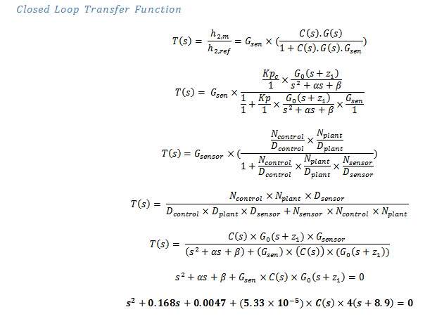

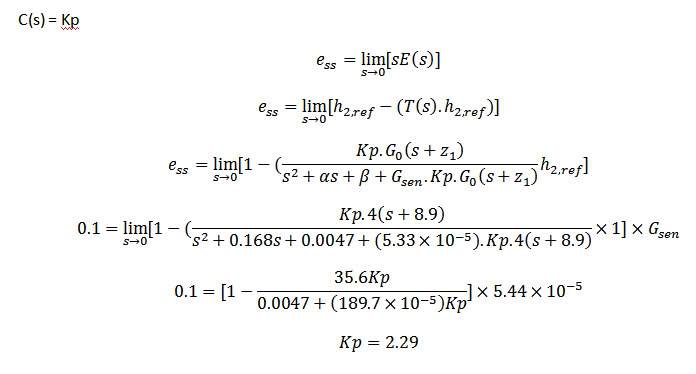

So this is a bit of a two-part question and I'm unsure which part I'm not doing right (or both!).
i) Find the closed loop transfer function of the system shown
ii) Design a proportional controller for the system to give a 10% steady state error
Any help, hints, suggestions would be greatly appreciated.
Thanks!
Go = 4.0
α = 0.168
β = 0.0047
Z1 = 8.9
G(sen2) = 5.33*10^-5
The reference level is 40mm (it's a twin water tank system)
Firstly, the CLTF
And the P-controller
Thanks for any help :D
1. In your CLTF panel. what's with the last two equations? You didn't try to isolate the pole locations... not that there was any reason to ... but your 1st equation is correct. I'm too lazy to work thru the rest of that panel.
2. As for the kp computation: Assuming your final T(s) is correct, just take
lim s → 0 of T(s). Using your derivation of T(s) I make that to be
T(0) = kpG0Gsens/(β + GsensCG0z1)
which you set to 0.1 & solve for kp.

Well, there was really no need to find the poles (yes, they are found by setting the denominator to zero) since you weren't asked to find the time response, just the steady-state error. And that, for a unity step input, is just T(0).
(Reason: step input transform is 1/s but the final-value theorem says lim s→ 0 of sT(s) so the s's cancel).
If you had been asked to find the time response to a step input you would, after finding the poles, have to do a fractional expansion of the entire T(s), includng the numerator, and then done the inverse transform on each of the terms of that expansion.
Or, if you got lucky, you might have found the entire T(s) in a table of transforms, then there would have been no need to find the poles.
