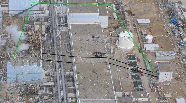

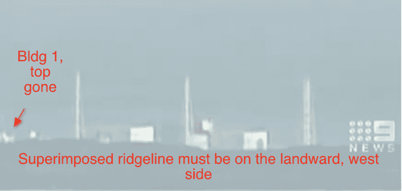

You almost had to be there. It was the beginning of the analysis of the photos coming out of Fukushima, starting with this still photo of the north wall of Bldg 4 after a fire and explosion, and the interpretation that there was a tongue of "something" hanging out of the side of Bldg 4 somewhere around post #500-600. There was debate regarding whether this was insulation or corium. The annotations in black letters were my own observations, added to the photo, and at that point in time there was speculation on my part that the SFP was on the north side of the Bldg. It wasn't
see:
http://i306.photobucket.com/albums/nn270/tcups/r735227_5964756.jpg
The new video is interesting. Notice the drywell cap in the northeast corner of Bldg 4 in the new video?

I the drywell cap is on the NE side, I would expect that the SFP is on the south side of the building.

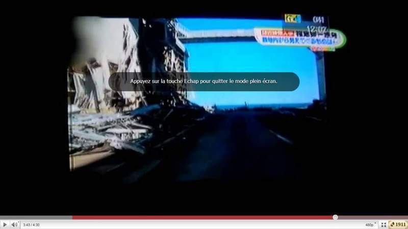

days earlier (page 26 or so) there was discussion as to what the molten material here was (insulation? corium?):
in the new video you can see a similar formation oozing over a wall (3:45 to 3:47)
looks rather innocuous IMHO

And doesn't look to be the same material in my opinion. The 2nd one appears to be a muddy water stain with no real bulk. The first one is yet to be determined.

timeasterday said:
Some video taken Sunday: http://peevee.tv/v/84w992
A few screen grabs from the video here: http://mainichi.jp/select/jiken/graph/20110327_2/
Any idea where the steam at video 3:25 to 3:29 originates from
later again at 3:49 to 4:04
seems to come from a crack in the concrete and quiet forcefully
any ideas?
