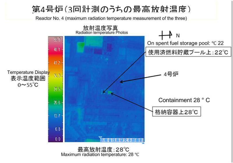

Er, I guess I wasn't clear in my earlier post - I was speaking strictly about Unit 4 SFP.
Some believe the way the building appears to be damaged that it is sagging from high temperatures. I guess only time will tell.

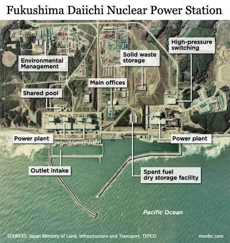

@AntonL @NUCENG @...
http://img.ibtimes.com/www/data/images/full/2011/03/15/74343-an-aerial-view-of-tokyo-electric-power-co-s-fukushima-daiichi-nuclear-.jpg
look at the pipes

That settles the issue - cladding it is

I did. There are some areas where the piping is broken. In one shot it looks like the pipe is disconnected at the building. This is probably due to the blast damage to the building.
In another shot a section of the piping is lying loose on a building roof. Again, from the destruction around it, it appears to be due to the explosion of the reactor building next to it (I believe it is Unit 3). The brief shots of the double run of the pipes in the video look like the were roughed up but I still don't see indications that they burst from overpressure insidee those pipes.
Some of these lines appear to be common vent lines from turbine and other buildings. Others may be offgas lines to the stacks. I worked for 15 years as an engineer at a single unit BWR-4 Mk I power plant in the States and am not certain how those systems are routed in a multi-unit site in Japan.

Here's one more image for good measure, taken on the overflight on march 17th. The vertical section looks to be of a different color for some reason.
