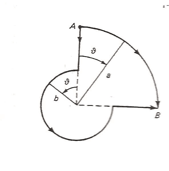

A force eld E has the spherical components
Er = (2Dcosθ)/r3 Eθ = (Dsinθ)/r3 E[itex]\phi[/itex] = 0:
(a) Evaluate by line integration the work it does in taking a point (parti-
cle) from point A in the diagram to point B via the quarter circle r = a; 0 < θ < =2. (See accompanying diagram.)
(b) Do the same for the path that includes the sector r = b < a; 0 < θ < 3[itex]\pi[/itex]/2.
(c) You should conclude that E is derivable from a scalar potentia via
E = -[itex]\Phi[/itex]. Find in a gauge such that [itex]\Phi[/itex](r→∞) = 0.
(d) Show that each piece of work you evaluated in (a) and (b) equals the
potential dierence between the endpoints of the piece.
a) w=[itex]\int[/itex]E(dot product)dl
b) i can figure out once i get a
c)not sure how to get E from just having E=-∇0 or am i over thining this
d) need some sort of elaboration on this part not sure what it's asking.
MY understanding of what I am doing would be a line integral so for parts a and b my guess would be to take the integral ∫aaErrdr + ∫0[itex]\pi[/itex]/2Eθrdθ + ∫E[itex]\Phi[/itex]d[itex]\Phi[/itex]
so it would come out to
∫0[itex]\pi[/itex]/2Eθrdθ which simplifies to D/r2
also i can't find the equation used for the below question anywhere in my book just help with the equation would be great
