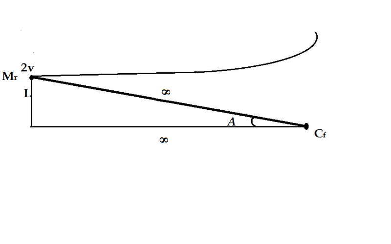

I have made the figure ehild.Please see that.
I have some problem in finding the initial angular momentum.
L=mvrsinθ.Here r=∞.
But from the figure
cosA=∞/∞=1
so A=0.
So the angle between velocity vector and position vector=180(joining both vector from tail to tail)
but sin180=0
So initial angular momentum is 0.Is it right.
This is the figure.
You can not calculate with infinity like that. ∞/∞ is not 1. Think about x/x2, both the numerator and the denominator goes to infinity, what about the ratio?
You never reach infinity. It is only a limit - you can increase something more and more but it is still finite.
Initially the point is very far away but still at a finite distance R. Rsin(A)=L.
So the angular momentum of the virtual particle is μ(2v)L.

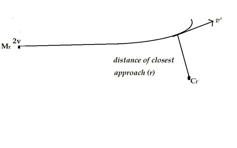

For calculating final angular momentum.
I have made a figure.
L=mvrsinθ(θ in this case should be equal to 90 I think)
Lf=μv'r.
Is it right?
Satvik Pandey said:
Ok I get that.
Lf=μv'r.
Is it right?
Yes. The initial angular momentum is μVL, (V=2vo) and the final one is μv'r, r is the distance of closest approach (the problem text uses D for it). The initial angular momentum is equal to that at the closest approach.
