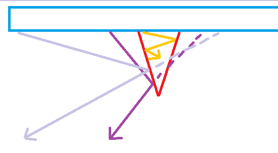

Many linear flourescent lightbulb fixtures that I see have this series of transversal fins, such as in this picture: http://www.bizrice.com/upload/20130409/T5_14w_embeded_linear_fluorescent_louver_light.jpg. What are they for? They are certainly not for efficiency, as the lamp would be more illuminating without them. My best guess is that they mitigate glare if you look at them from certain distant angles. Anybody can think of another reason?

Thank you for the awesome reply and asking your sister about it. Still, it makes no sense to me. Let me illustrate it with a drawing.
If my logic is correct, the purple and violet rays coming from the left side and reflected on the fin would have perfect equivalents on the right side, that would have "filled in" for the reflected ray, if the fin was not there. Any rays on the right side and being reflected would also have other rays filling in for them that came from the left. All the fins seem to do is provide opportunity for light to be lost, reflected inside the fins, as per the orange ray. Fins only make sense if they are placed on the corners, where there are no other side of the lamp to provide "fill in" rays.
Can you show this to your sister and see what she thinks? Thank you!
So the way she explained it was that because it captures some of the rays (orange) that would go straight down(ish), that helps make the middle a little dimmer, and the purple rays get bounced out farther away from the fixture, and the dotted purple lines end up going close to straight down. that way you can have a fairly even distribution of light in a decent radius from the fixture and more light being dispersed outward from the light which is dimmer, but due to the other light fixtures around it producing the same effect, it can produce an even light distribution across a large area instead of just a bunch of bright spots surrounded by dark areas.

just to add though, a large proportion of the light that is "caught" by the fins will be reflected back up into the unit (it will be much nearer to vertical than the orange line in your diagram) and some of it will come out again at a wider angle, so that keeps the efficiency/overall brightness up.
I don't think the light comes back out of it after so many reflections, and if it does it will likely come out so weakened that it will hardly help with illumination. See the drawing in the link below.
That still makes no sense to me. Rays from the dotted lines would go exactly where the reflected ones would go, provided there was no fin there blocking them. So reflected rays are no more, no less dispersed than dotted ones would be!

I am just telling you what she told me. I do know that you have to follow the rays on your diagram all the way to the floor in order for it to make any sense, and you have to do every direction from every point on the bulb that produces light, your 5 ray diagram does not do my argument ANY justice, but if you were to do an actual analysis, what I have given you holds water.
Just remember to follow the rays using the laws of reflection, and it will go to where it is going to go. If the fins on the fixture did nothing, then offices would just have light bulbs in the ceiling with no fixture to disperse their light like what they had back when these bulbs were first invented. I apologize for not being able to explain it in a way that makes sense to you, maybe you could email the company and ask them to tell you what its all about.

I know they have a point, or the manufacturers wouldn't waste extra resources in manufacturing them. I found the following text in a document from the Light Studies Lab of the faculty of Architecture of a Brazilian University, which translating reads:
"Aleta (fin)
A small tab, fin or grill. Placed in series so as to impede the direct vision of the lightbulb from a range of angles. It serves as an anti-obfuscating resource, and contributes to the distribution of the light flux, together with the reflector, in more modern lamps".
So this confirms both your sister's explanation, as well as my initial theory that they serve to stop you from looking directly at the lamp from far away. But for fully understanding your sister's point I think I would need a tridimensional diagram. Does she recall seeing something like this in one of her college textbooks? I can try to find it.
That is very true, Everything she did was in a special CAD program and it took hours to run each time that she needed to see what the dispersion would look like. I will ask her, but she took 12(ish) different courses that directly related to lighting, so I doubt that she will be able to remember which textbooks dealt with what aspect of lighting. I can also try to find one of the university's websites that might have it for you.

I believe that the primary purpose is to obfuscate view of the direct light source. (I'm not sure the manufacturer is correct is his use of the term 'anti-obfuscating' or, at least, it's confusing.) Certainly, it would reduce the overall light output, as no reflector is perfectly efficient. It's a lamp shade, in other words, used for much the same reason we use lamp shades around incandescent light bulbs. We do not fit those to increase the efficiency of the lamp, but to reduce the harshness of shadows produced by the pin-point source and shield our eyes from direct view of it.
If the light source can be viewed directly our eyes adjust to the bright source, making the apparent brightness of its surroundings less. Therefore shielding the source will improve the perceived brightness of the illuminated area to our eyes. (Pet peeve of mine: poorly designed streetlights that make it difficult to see because they are so bright!)
The shape and reflectiveness of the shield is a secondary consideration, in my opinion. Given that having a shield at all is more desirable than none, efforts are then made to use it to even out the light distribution and make it as efficient (or less inefficient) as possible by reflecting the light that would otherwise be absorbed by a non-reflecting shield.
