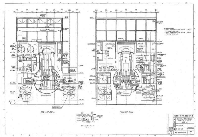

I am attaching horizontal views of Fukushima 1 unit 1, looking north and looking west. Units 2-5 are somewhat different, but it should still be a useful reference.
Thanks, but those are hardly new. The drawing of the refueling floor in Unit 4 is new and finally confirms the layout of the reactor well, the SFP and the oblong equipment pool. A lot of what we had surmised about the layout is now confirmed.

SteveElbows said:
The caption isn't brilliant, but I have some sense of where this photo is taken, due to the yellow containment cap location which we know well.
Camera is pointing North, so equipment pit is in the far distance. Reactor well is just in front of cameraman, and cameraman could probably have shot the next photo of the reactor well without moving, just by pointing camera down and to the right somewhat. This may not be what actually happened, as reactor well photo may have ben taken from opposite side, I am just trying to illustrate what I believe to be the camera position relative to reactor well in the photo you mention.
That is more or less my take on it as well. We know the cap is on the west side of the floor, so the camera pointing north makes sense. The damaged roof at the north side also fits the external photos we've seen. The equipment pool is likely the farthest thing away in the picture, extending back towards the north wall (or what's left of the north wall), and the caption seems to say the opposite.
  • #10,430
joewein said:
I wish those two structures where shown on the floor map as the green one is.
It's hard to say what the whitish structures are. Obviously they've got cranes on them. My guess is they're special equipment needed for the core shroud replacement work, and wouldn't appear in the original blueprints at all. Regardless, they could have been drawn in overlaid on the floor plan, so I'm with you there. It would have made things clearer. I also have to go back and look at the pictures taken from the outside by the aerial survey and T-Hawk drones. I don't remember seeing the white bridge-crane support steel anywhere before these latest pictures.
