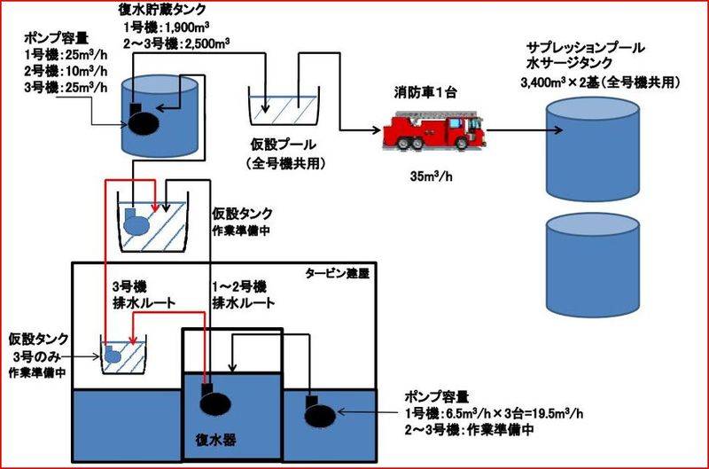

Is it even possible to 'wash out' the reactors and distribute fuel wherever the water goes?
Have they had the available water pressure to move out broken/melted fuel rods; I'm assuming the fuel is pretty dense..
Or, is that exactly what they've been doing for 10 days: flushing out the cores to prevent further explosions?
If so, the groundwater and the pacific will get a battering.
If the radioactive water is left standing in cement ponds, like the Turbine Building floor, most of it will be fitered out by the concrete as the water seeps through it. That happened at Three Mile Island.
Fuel washout is possible when the cladding is breached and the opening is relatively large - several mils or mm. Grain size of the ceramic is on the order of 10 microns, but there is usually a sized distribution, from ~1 - 20 microns. On the surface, there is some restructuring as a function of burnup, and the fuel subgrain structure forms with sizes on the order of 10's of nm.
If the fuel grains wash out, they go with the flow. If there is no flow, then they would settle toward the bottom of the core, or down through the plenum under the core plate.
Now, with the seawater, I have to wonder if some of the fuel particles will actually dissolve, in which one then has a solution, e.g., uranyl chloride. I don't know of any research into the chemical behavior of spent fuel in seawater.
Any solution could flow through any opening in the system, and possibly to the torus or plant discharge. If they are detecting fission products in the discharge to the sea, then it's either fuel particles or fuel and fission products in solution.
I think the main focus has been on cooling the remaining fuel. I am concerned about the use of seawater though.
