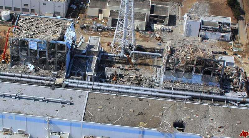

|Fred said:
Thank you Tcups, I'm glad to contribute to the collective quest for plosive answers that lead for a fair amount .
There is one thing that I'm still not to confident with :
What are we seeing bellow the arrows It is supposed to be a strait wall.. How do we explain what we are seeing ?
[PLAIN]http://i.min.us/ikEmCk.jpg[/QUOTE]
Well, if the theory is that the FHM went ballistic and crashed downward through what was left of the roof on that side of the building, there could have been quite a bit of debris that ended up in the equipment pool -- parts of the roof, the FHM itself, etc.
Photoshop says it is some sort of complex, box-like structure partially covered with debris and with a bit of sun and shadow thrown in just for fun. Some piece of equipment? Don't know, but it is clearly in the pool and appears to be separate from and in front of the common wall with the upper dry wall containment.
An upright piano, maybe?
http://i306.photobucket.com/albums/nn270/tcups/Screenshot2011-04-05at74000AM.png
http://i306.photobucket.com/albums/nn270/tcups/Screenshot2011-04-05at74307AM.png
http://i306.photobucket.com/albums/nn270/tcups/Screenshot2011-04-05at73942AM.png

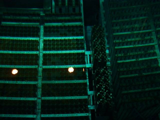

. . . no -- here is a shot straight down into the pool with the shadows brightened:
http://i306.photobucket.com/albums/nn270/tcups/Screenshot2011-04-05at75953AM.png

|Fred said:
Thank you Tcups, I'm glad to contribute to the collective quest for plosive answers that you lead for a fair amount .
Well, we are looking down at the equipment pool, essentially a straight-walled rectangular pit. The wall at the far end of the pit is where it interfaces with the reactors top area. This wall appears bright at the top, and darker below, your upper arrows points approximately to where the color changes. The bright part I interpret as some concrete top slab, designed to fit into the concrete slabs that lies on top of the reactor, and below other slabs, vertically jigsawed together, so to speak to form a wall. Several objects have fallen into the pit, most conspicous is a huge rectangular slab, which is leaning across the pit from the bottom left wall, and almost to the top right wall. it can be seen as a grey object just below your lower arrow. I looks to me as a kind of gate that fits in at the far wall, covering the slabs
  • #2,917
Two additional things to note from those images. The location of the steam appears heavily discoloured black (on the beam). This is visible on the later clip where no steam is venting.
Secondly, on the side opposite the location of the red arrows, there is seemingly a void where the main floor slab has been blown out, or collapsed in. At least, that's how I read it given my assumption there were no openings in the floor on either side of the SFP delivery channel.
/edit : From the angle the image is taken, the black area should be the outside wall of the containment vessel in shade. Surprised it's SO black considering it's proximity to the opening giving us the view through along with enough daylight to provide some illumination.

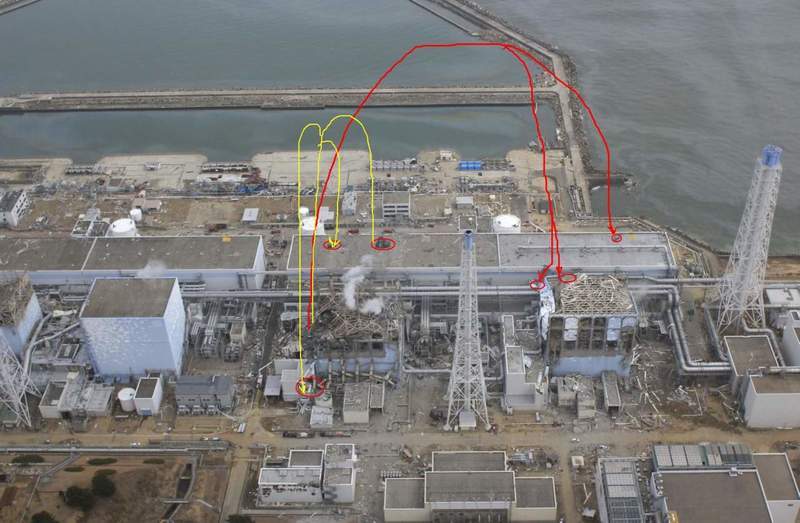

PROPOSED MECHANISM FOR 3-PHASE EXPLOSION OF BUILDING 3
|Fred said:
Dear Panzer-armadillo
I'm a not to fresh those days.. Probably need more sleep. I apologize if I don't get you the first time.
[PLAIN]http://i.min.us/ikuqtC.jpg
I have the impression that we are seeing something like this..Why do you think the explosion toke place bellow the slab?.
H leaked likely on the SFP side, the ignition toke place on the south wall above the SFP it only blew the operating floor south wall
Does it mean the pool was empty or full ? I'll go for full
How do we explain the upward explosion catapulting the FHM in the air?
Cheers
|Fred:
The short answer is that a hydrogen explosion on the top floor does not explain what we see and cannot launch the FHM upward. That is the key.
The only thing that launches the FHM upward is steam, because if all the water is gone, then the pool is just full of hydrogen like the rest of the upper floor and there is no differential pressure under the FHM when it blows.
How do we get steam under the FHM? Only way is superheated gas blasting out the transfer chute.
How does that happen? The containment is full of nitrogen and hydrogen venting occurs to the outside of the containment.
Remember the lateral acceleration forces from the 9.0 quake that exceeded the design parameters of Unit 3? I was wrong about the weak spot being the torus-to-primary containment link.
Here is a radiologist's interpretation of Fig. 3, which is the critical information needed here.
http://i306.photobucket.com/albums/nn270/tcups/Screenshot2011-04-05at100427AM.png
That big old steel reactor vessel sets on a pedestal like a long, skinny boiled egg. It is made of heavy steel, and it is full of water and one of the densest things I know of -- uranium.
The structures in red are pneumatic shock absorbers of some sort. They are intended to stabilize said "egg" in an earthquake if anything gets tippy.
The torus is in the ground and all that massive concrete structure, not to mention the steel liner inside the primary containment are MASSIVE and firmly anchored to the ground.
If the lateral acceleration forces exceed the design parameters, the pressure vessel risks becoming the upside down clanger in a giant bell shaking at about a 9 on the Richter scale.
The key vulnerable structure if that happens is the high pressure steam outlet pipe. If that cracks or leaks, then you have high pressure steam and shortly thereafter, hydrogen in the primary containment, but not in a huge blast, as the torus suppression pool is meant to (hopefully) handle. Apparently that didn't work out so well at Unit 2.
Now, I can put live steam and hydrogen gas in the primary containment displacing the nitrogen. I can't tell you the exact route to the lower building -- probably via the torus pool then lower floors and up through the lift shaft.
Anyway, pressure differential vs. atmospheric pressure in the vessel doesn't go to zero, but neither does the pressure build to the same level as an RPV without the damaged pipe and leak. Operators might interpret that as "hold off a short while and let's hope to God the generator gets hooked up and we can cool this off before the pressure goes too high, because Unit 1 exploded when we had to do that the last time!" *
Addendum:
*actually the operators had already manually vented the primary containment at 8:42 AM -- but perhaps this also let to more hydrogen in the upper containment, but it means the leak, if there was one either was not so large as to negate the need to vent the RPV, or, perhaps that the rising pressure in the RPV added to the severity of the leak before it was vented.
In the meantime, some hydrogen could have escaped the the drywell cap seal as well as the transfer gate seal, maybe even a pressurized stream venting to the upper building.
The reactor vessel is now mostly dry, really, really (red?) hot, and making hydrogen and oxygen. **
Addendum: ** the explosion(s) occur at 11:15 AM. Thanks for the timeline chart (below)
BOOM! Gas in the primary containment ignites, blows the drywell cap, and blows out of the transfer chute, and to a lesser extent, out of the gate to the equipment pool. This 1) causes a secondary explosion of the hydrogen above, but more importantly, 2) vaporizes the remaining water in SFP3, turning it into a steam cannon and the FHM goes ballistic. BOOM!
The fire and explosion in the upper building propagates to the lower floors which have their own hydrogen, but the pressure from above means that the primary force of the tertiary explosion in the lower floors goes outwards through any path it can find. BOOM!
Now you have the mechanism for the initial fireball at the southeast corner, a ballistic FHM, damage to the equipment pool, blown out upper building, and blown out lower building including the access tunnel, all without a gross breech of the RPV (ie, melted fuel melting through the steel of the RPV).
Debunk that. :biggrin:

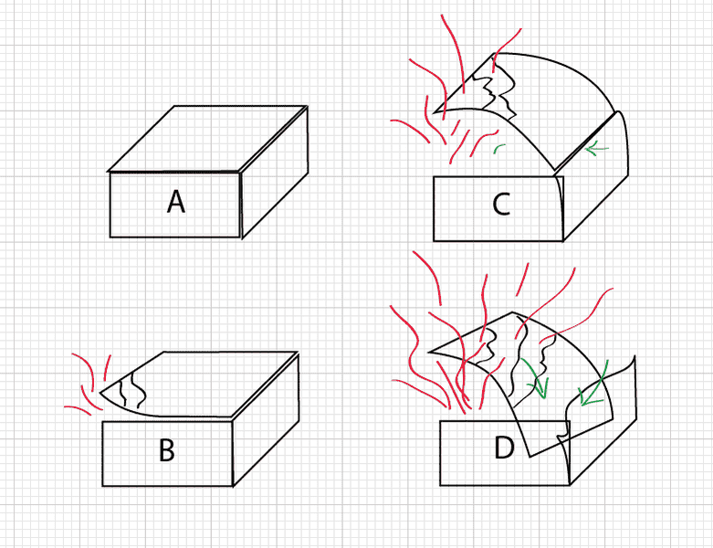

Fred said:
[PLAIN]http://i.min.us/ikuqtC.jpg[/QUOTE]
This estimated damage looks consistent with the Oyster Creek sketch, where the upper part of the pool wall seems to be made of interlocked concrete rings...
[PLAIN]http://img847.imageshack.us/img847/7598/oysterplug.jpg

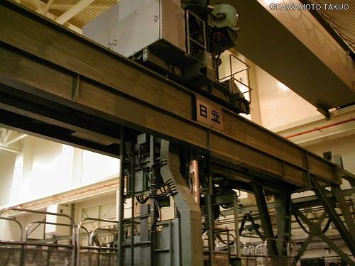

TCups said:
... I don't know if that makes perfect sense, but it is all I can conceive to put enough kinetic energy under the FHM. ...
Ballistic fuel handling machines is one of the most creative, out of the box and enetretaining thoughts on this forum.
However, it may just have been parked at the other end of the building, examine at below pics and from the rails on floor one can note that the machine can traverse the building north south or at least such that it can serve all the reactor in the center.
Furthermore, I presume that you will not want to park the FHM over the SFP , that way you minimize the FHM exposure to radiation from the open pool top, so that it does not slowly get radioactive.
[URL]http://posterous.com/getfile/files.posterous.com/billwarner/gbUyXtvgp1FtEJh42PIxIQmyui6J4AkDQt4VonEvEsdqT4673jaZvS2el9eL/rflg-fl2.jpg[/URL]
[URL]http://posterous.com/getfile/files.posterous.com/billwarner/CCk6zJXe49Enj3Fop4ELpKsth2FfRdpaNRMXPGCueXDaGxArPngCOWgWAsA3/rflg-fl1.jpg[/URL]
  • #2,939
[PLAIN]http://posterous.com/getfile/files.posterous.com/billwarner/CCk6zJXe49Enj3Fop4ELpKsth2FfRdpaNRMXPGCueXDaGxArPngCOWgWAsA3/rflg-fl1.jpg[/QUOTE]
You could be right. At the end of the day, I will never be able to prove or disprove what I have proposed, so it is (or has been), most likely, a gigantic waste of time or effort. Maybe it was just hydrogen exploding upstairs. That's what all the news media say.
So, for now, I will just leave it at that and sit back and listen for a while. I am woefully behind anyhow.
Later.
