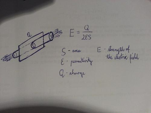

2. It says this: If we imagine 2 cylinders with the same base of area S on a charged board (Q charged). The "force lines" that are coming out of that part of the board are going through the two second bases of the cylinders so the strength of the electric field by Gauss law:
\begin{equation}E=\frac{Q}{2\epsilon S}.\end{equation}
Sorry because of the bad drawing, the cylinders are attached to the board in 90°...
I'm not quite sure what they mean by this text... Do they mean - because the force lines are only going in these directions on a charged plate (←→), if you connect a non-conducting (? they don't say what kind of a cylinder it is) cylinder, they would still go in these directions, because of the polarisation of the cylinder. If it doesn't polarize, if it's a conductor - then both of the charges will flow in any of the directions (depending on the fact in which cylinder they flew into), and they will accumulate on the flat surface, while not many will accumulate on the curved one (?)...

2. Again there is a symmetry imposed by the charged board. In order for this symmetry to be perfect, the charged board has to be an infinite plane and to have homogeneous charge density across all of its infinite surface. The cylinders we consider (it is actually one imaginary cylinder crossing the plane ) in order to apply Gauss's law have to be imaginary. If they arent imaginary and they are conductive then they break the symmetry, the symmetry law doesn't hold and by just applying Gauss's Law alone we can't conclude the result regarding the magnitude of the electric field neither its direction.
So big conclusion is , in electrostatics, Gauss's law is applied on an imaginary closed surface and usually with a help of a symmetry law.
