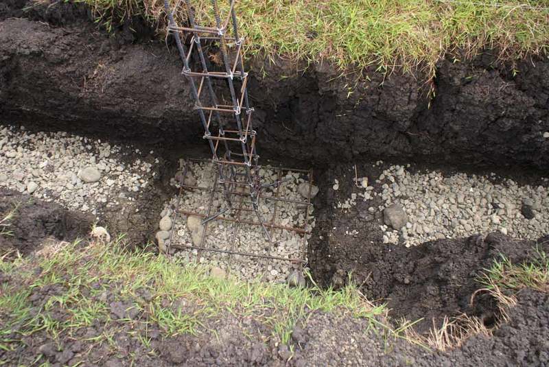

file attached is picture of the footer.
It is what we commonly use.
Why.. would precast slabs need different footings? But precast slabs are expensive so I don't consider this.

Nice picture
So these are pad foundations and you also have the excavations for what we call a ground ring beam.
One purpose of the ring beam is to stiffen the edges of the ground slab (to prevent edge curling) and also to hold the whole thing together if there is local loss of support under the ground slab as the ground settles over the years.
I also do not see any significant seismic strengthening of the connection between the pads and the columns in your picture. In an earthquake (or even for building wind loading or thermal movement) the columns will pivot about their joints with the pads so these points should be regarded as pinned or ball joints.
One point I made earlier about the leverage of earthquake disturbance affects your roof.
I hope you understand leverage?
If you have a heavy lump waggling about on the end of a long lever you have a large effect.
The longest lever is up to the roof so a heavy (concrete) roof is most vulnerable to seismic activity. Further if it crashes down on the floor below it it will a great deal more damage than a light metal roof which might come off but could well save the structure and be easily replaced.
Please also remember this all is friendly advice, I am not acting as an unpaid structural consultant, nor would PF want me to.

First. The picture is not mine. I just saw it at the net (and shared it to illustrate the idea of column footer). Second, the construction of the building I'd lease hasn't started. We haven't even started excavations yet because the final design of the building are still being done due to my changing the 3 storey to 2 storey. Anyway. Thanks for the many tips. I'll think and remember about them one by one. I'd also recommend the architect and structural engineer to use ground ring beam... as the original design is only one column footer at every corner. The picture I shared with you is from a person building a fence. I just shared it to illustrate a column footer. Thanks again for the tips. This will do for now.

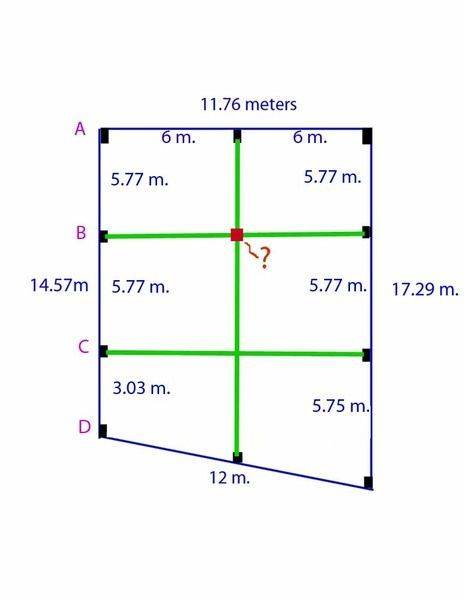

Hi Studiot,
I've been thinking something for half a day and needs your comment.
Please see the file attached picture. I'm deciding whether to add a column in the middle (marked in red). The architect wanted me to decide.. and I didn't have access to his structural engineer and he can't discuss with me anything structural because he said his specialty was architecture and not familiar with seismic loading or torsions.
Last I talked to him early today I wanted him to add the column at middle. He said it is ok. But then remember in the torsion article any unevenness in structural can introduce twist. Imagine "B" (in the picture) has column at middle while C doesn't. Imagine a seismic wave passing from left to right. This would make the C move differently from B and introduce torsions?
Also something perplexes me. The beam from top to bottom middle are not girder because they are same level as the horizonal beams.. meaning imbedded into each other. Supposed there was no column in the middle of "B". Would the load be distributed to the horizontal and vertical beams (in the picture)? Or would the horizonal beams be the main support and the vertical beam just to holds up the floor slabs? What is usually the case?
Note in the construction project. No precast slabs would be used. They would all be poured concrete and rebars.
So should I add the column in the middle of "B" or not? On one hand, I'm on tight budget and the architect said the "B" side beams would be smaller since they would be 6 metesr apart... and it would also support the 12 meter RC beams at "C" making cross beams. Would this make the loading at "C" distributed to the vertical and horizonal beams?
Actually one month ago. He told me it's nicer to have no columns in the middle. But now said it is ok because I'm on tight budget.
Now I'm quite undecided. I guess seismic considerations would be my primary concern in whether to put the middle column or not.. but then.. if "B" and "C" has no columns at middle... and "A" and "D" have them.. it would still introduce unbalance seismic loading for waves that come from left to right?
Lastly. The connections would be standard connections, the loading is simply one floor above or simply 2-storey with metal sheet in the 2nd floor roof.
What do you think? Column or no column at the middle of "B", that is the question?
Thanks.. this inquiry is my last question in this thread, don't worry :)

I am not of the opinion that an extra column will do much for earthquake performance, in fact it may reduce it.
In post#21 I drew attention to the important key statement in your code.
The way to enhance earthquake performance is to make the horizontal elements more flexible. This way they can dissipate the quake energy input to the structure.
The whole matter depends upon the design of these things (again including the connections).
You should ask your structural engineer to explain.

Problem with long span is the connections must be made perfect. Also in most homes, the distance between columns are 6 or less. It is unusual to find homes with distance between columns of 12 meters or more. Have you thought why.
Anyway. I let them added a column in middle yesterday making the span of one portion 6 meters instead of 12. This would save much steel and make the constructions cheaper.
Also for the 2-storey with metal roof. I let them design it for 3-storey foundationa and structural. I assume using 3-storey structural in 2-storey building would make the columns stronger and more earthquake proof. Any wrong with this idea? I know you would say to make it more ductile. But using 3-storey foundations and columns would add more steel making it stronger. What's the problem with this?
