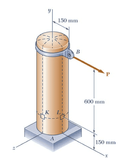

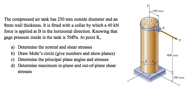

Thin walled pressure vessel with external force
In summary, the conversation discusses the use of longitudinal and hoop stress equations to find the shear stress in a pressure vessel. The speaker is unsure about which equation to use and questions whether the external load will create shear stress. They also consider the possibility of another type of stress being caused by the gage pressure.
SteelDirigibl
40
σ=pr/t (hoop)
σ=pr/2t (longitudinal)
τ=VQ/It
I have longitudinal stress and hoop stress. I'm trying to find shear stress, which should come only as a result of the 40kN from the collar correct? I'm confused with how I can get this on the pressure vessel. Would it be the same as if it were a simple rod?

Are you sure you want to use tau = VQ/It? Think again about this.
What sort of stress does the external load create in the pressure vessel?
It has to be shear stress doesn't it? The gage pressure doesn't cause any shear stress, right?
Does it cause another kind of stress too? Or am I just wrong? Can I get a multiple choice? :smile:
