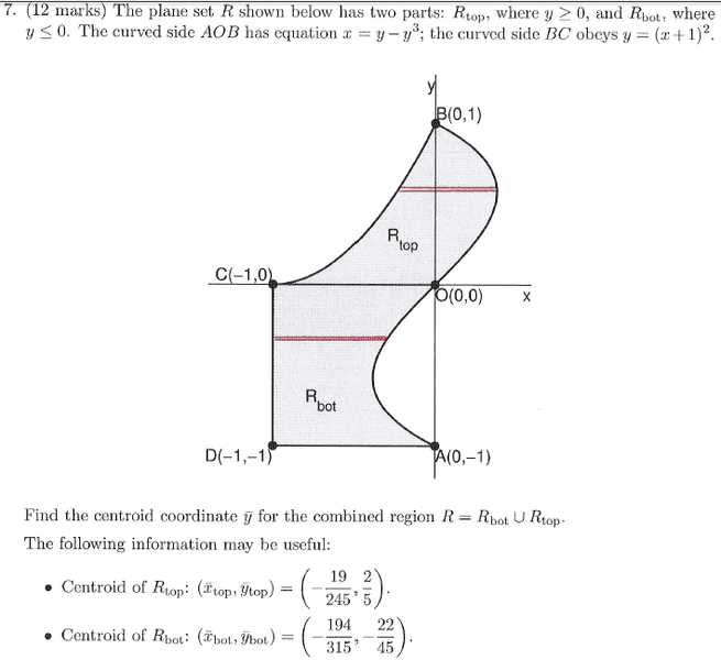

I tried to do this problem by taking the average of the y-bar centroid values but that gave me the wrong answer. I am only interesting in knowing why this method is incorrect.

What is the definition of centroid? Your method would be valid if the areas of the two regions were equal.
It can be shown that the centroid of the union of two (non-overlapping) regions is the weighted average of the two centroids, weighted by the areas of the regions. That is, if the two regions have centroid [itex](x_1, y_1)[/itex] and [itex](x_2, y_2)[/itex] and have areas [itex]A_1[/itex] and [itex]A_2[/itex], respectively, then the centroid of the combined regions is at
[tex]\left(\frac{A_1x_1+ A_2x_2}{A_1+ A_2}, \frac{A_1y_1+ A_2y_2}{A_1+ A_2}\right)[/tex]
As your grandmother should have taught you, don't take an average of averages. If an elephant and a flea get on opposite ends of a symmetric seesaw, will they balance? So where's their combined centroid?
