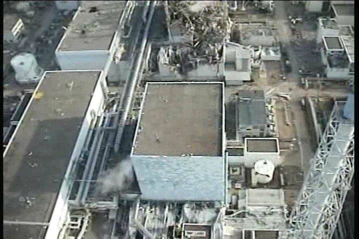

  • #2,419
TCups said:
I can suggest one: superheated steam & gas blow out the fuel transfer chute into the upper SFP (water already hot, or boiling, rapidly vaporizing the water, and resulting in an upward focused blast out of the SFP, launching the FHM skyward, yanking a fuel rod assembly out of the pool as it shoots upward, then crashing on the north end of bldg 3.
I had thought that the original blast at Bldg 3 is on the SOUTH end of the building. The damage on the north end sends stuff crashing downward. If the blast photo is taken from inland, looking eastward, then the blast is to the right, southward. Two towers bracket Bldg 4, on the blast (south) side of Bldg 3. A large hunk of debris comes down on the north side of Bldg 3. But the more I look, I can't make that orientation fit with the towers. Someone help me here.
http://i306.photobucket.com/albums/nn270/tcups/Picture28.png
http://i306.photobucket.com/albums/nn270/tcups/Top.png
Doesn't this view have to be from the west?
@TCups: look at 1:51 in this video. Something heavy is falling down and is deviated, or turned around, by the big antenna, so we can presume it landed very close to the antenna:
https://www.youtube.com/watch?v=YN8tzmtQv8g
Might that be part of the FHM?
EDIT: I corrected the youtube tags. Also, I am not completely sure whether the object I mentioned is turned around or it simply partly disappears behind the antenna. What seems clear is that at least three objects fall. Two simultaneously (or they might be parts of the same, big, object) one to the right and one slightly to the left of the antenna. Then a third one, about a second later, and to the right of the antenna...

@Tcups: Regarding your latest scenario (the flying fuelmachine). I can't find fault with it thus far, particularly because it ties together bits of information that didn't make sense before, especially how these rods could have ended up on that side of the building. While it seems a wild theory to have them attached to the entire FHM, which does a backflip through the air, it all fits with what we can see. Note that most damage to the buildings where the FHM now sits was caused by the explosion and debris of the wall BEFORE the machine landed on top of the rubble. Also for the FHM to be able to drag a fuel bundle along without it shearing off, it must have been propelled upward almost vertically, which corresponds with it landing close to its departure point.

FLOOR PLAN LAYOUT OF REACTOR BUILDINGS 3 AND 4, TO SCALE, HIGH RESOLUTION
Astronuc said:
As for atomicinsights, I wouldn't put a lot of stock in the article.
The Fukushima units are not the same as Oyster Creek, even though they may have Mk I in common. I'm not aware of upper and lower SFP pools.
Astronuc:
'tis true Oyster Creek is probably a bit different layout. My Illustrator skills are not as good as Photoshop, but I took this diagram
http://www.flickr.com/photos/60551543@N04/5531996321/sizes/z/in/photostream/
Did a scaled overlay sketch of the floor plan layout of the reactor access floor . . .
http://i306.photobucket.com/albums/nn270/tcups/Picture63.png
Copied it to Photoshop and touched it up . . .
http://i306.photobucket.com/albums/nn270/tcups/TopFloor-Floorplan.jpg
Scaled the measurements and structures relative to the high resolution top down views from the fly-over provided by Fred's post (there is some distortion due to differences in perspective between the two buildings), and come up with something like this.
http://i306.photobucket.com/albums/nn270/tcups/aerial-floorplan.gif
It may not be exact, but I expect it's pretty darned close -- as close as I can come without the actual floor plans.
I believe there are upper and lower pools on the south side, but one of the pools, at least on the only diagram I seem to have that shows this region of a Mark I, is narrow and deep. It seems to have a transfer gate. Is it for temporary cask storage? One important feature, if the layout is correct -- the fuel handling machine would not straddle the additional small pool on the south side. It can be accessed with the large overhead crane. I the diagram, it would seem to be a place where the yellow cask being lifted up the chute would be placed, and in that location, the spent fuel rod assemblies could be placed "wet" in the fuel cask.
