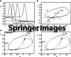

To me, the Morris-Lecar is at least conceptually easier to understand. I like the description of the neuron's channel populations. Plus, you really need two dimensions to have oscillatory behavior in a deterministic (thus, mechanistic) system, which leads to confusion (as you noted, it looks like the system can never fire again... and it can't as far as true continuous descriptions go. You choose a threshold for it and "artificially" introduce the spike and reset the position to subthreshold.
Standard mathematical analysis of the Morris-Lecar neuron seems like a nightmare though; it's a system you want to understand graphically (and thus numerically) by looking at it's nulclines, fixed points, and typical numerical solutions in different regimes (Fig 3):
http://pegasus.medsci.tokushima-u.ac.jp/~tsumoto/work/nlp_kyutech2003.pdf
If these terms are unfamiliar, there's a book on analyzing these kinds of models by Strogatz called "Nonlinear Dynamics and Chaos". The graphical analysis is in the first couple chapters.
(The Tsumoto paper above has several different papers floating around titled this. I think there's three different sized papers I've found. This is the medium sized one, the smaller one is a symposium, and the I can't seem to find the bigger one that that goes into more detail.)
