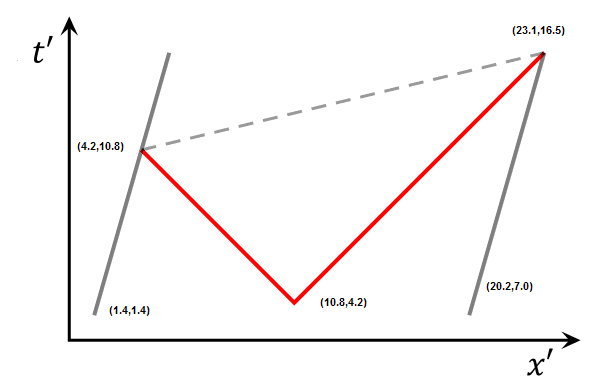

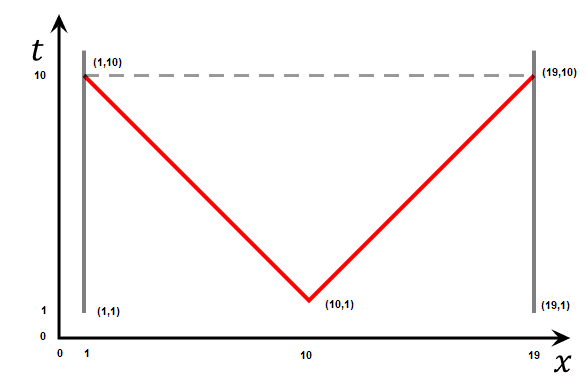

I have taken the train spacetime diagram from the wiki article and eyeballed in some coordinates for the five events. I show the coordinates as (x,t):
Notice that I was careful to make sure the paths of the light flash are on a 45 degree angle, meaning that the value of the x-distance traveled is equal to the time interval, which is 9 units of time and 9 units of distance in both directions. And notice that the light hits both ends of the train at the same coordinate time of 10 units, marked by the dashed grey line.
Looking at the second diagram, I eyeballed in the speed of the train as 0.3c. Since we are transforming from the train's rest frame to the platform's rest frame and the train is moving to the right, the rest frame of the platform is moving to the left, so the speed we want to use is β = -0.3 which means γ = 1.048.
Using these two factors in the equations above for t' and x', we get a new set of coordinates which I have drawn into the second Wiki spacetime diagram for the rest frame of the platform:
Notice that this time, I didn't have to do anything special to make the red paths of the flash of light go along the 45 degree diagonal. The Lorentz Transformation takes care of that automatically. You can verify that the light takes 6.6 units of time over that same distance to hit the rear of the train and that it takes 12.3 units for the path to the front of the train. The dashed grey line shows that the light reaches the rear of the train much sooner than the front of the train.
Now if we had drawn these diagrams on graph paper, we would be able to draw a horizontal line and show that the length of the train was contracted by the factor of 1/γ or 17.2 units.
