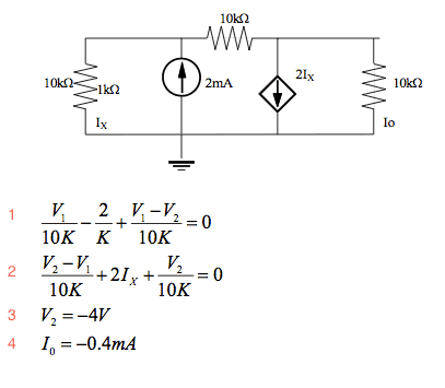

Need help with Nodal Analysis. I have the work, just need a step explained.

1 and 2 in the diagram are the nodal equations. Considering that the left node is V1 and that the right node is V2. I don't know how to get from the nodal equations to step 3. I know that you go from step 3 to step 4 using V=IR.
I tried solving the nodal equations to get to step 3...
Can someone please work it out for me? Thank you
Please help
In (2) replace Ix with V1/10K. Solve for an expression for V1. Substitute this expression for V1 into (1). Solve for V2. All done.

Ohh wow. Now I feel dumb(er, as many would argue here at pf)...
Thanks for the help gneill!
