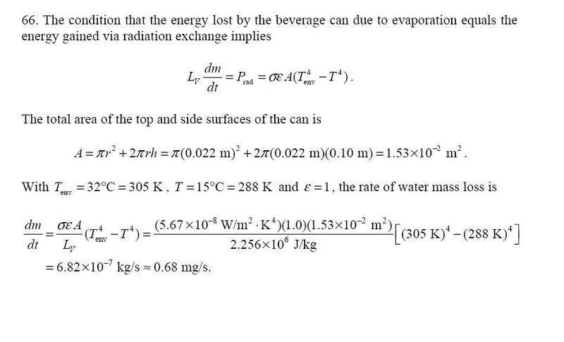

A cold beverage can be kep cold even on a warm day if it is slipped into a porous ceramic container that has been soaked in water. Assume that energy lost to evaporation matches the net energy gained via the radiation exchange through the top and side surfaces. The container and beverage have temperatures of 15 degrees C, the environment has temperature of 32 degrees C and the container is a cylinder with radius of 2.2cm and height of 10cm. Approximate the emissivity as 1 and neglect other energy exchanges. At what rate dm/dt is the container losing water mass.
Now I have attached the solution from the solutions manual. However my problem with the solution is shouldn't it be considered that heat must be transferred to bring the temperature of the water up to 100 degrees C?
No … evaporation happens without any change in temperature …
even at "room temperature", some of the molecules are going fast enough to get away! :biggrin:
