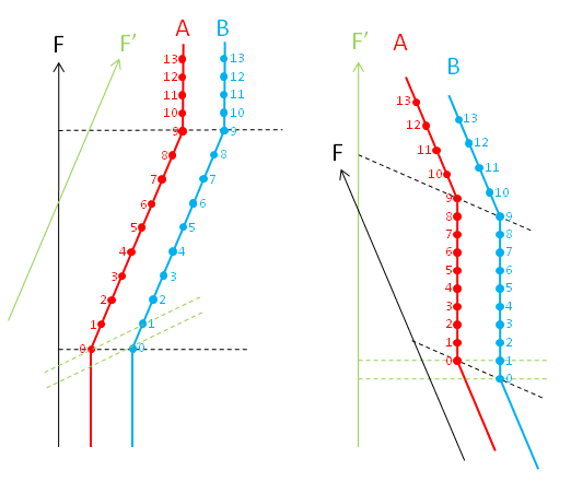

In a frame where the clock A that was accelerated was not ticking slower than B (because A and B initially had a nonzero speed and A's speed decreased after accelerating, from the perspective of this frame), the reason A was behind B when they met was because they were not synchronized in the first place (always remember the relativity of simultaneity!). In this frame B's time was always ahead of A's time by a constant amount prior to A accelerating, and after A accelerated its reading was "gaining on" B's reading, but not fast enough for it to surpass B's time by the time they met. If A was allowed to continue on at constant velocity past B after they crossed paths, then in this frame A's time would eventually surpass B's time.
Note that I gave a numerical example that worked like this back in post #64:
Suppose for example A and B are a distance of 60 light-seconds apart in the "stationary" frame K, and both are synchronized in this frame. Then if A is moved at 0.6c towards B at the moment when both clocks read a time of t=0, it will take 100 seconds in this frame for A to reach B, during which time A will only tick 80 seconds due to time dilation (the Lorentz factor being 1.25), so when A meets B, B will read t=100 seconds while A reads t=80 seconds.
Now consider things from the perspective of the inertial frame where A and B were initially moving at 0.6c and then A was accelerated to come to rest in this frame while B continued to move towards it at 0.6c. In this frame the clocks were not synchronized initially, so when A read t=0, B already read t=36 seconds according to this frame's definition of simultaneity. Then it takes 80 seconds in this frame for B to reach A (because the initial distance between them was 48 light-seconds in this frame due to length contraction, and 48 light-seconds/0.6c = 80 seconds), during which time B only ticks forward by 80/1.25 = 64 seconds due to time dilation, meaning B reads t=36 + 64 = 100 seconds when they meet, while A reads t=80 seconds when they meet. So you see that both frames make the same prediction about their respective times, even though in the first frame A was ticking slower while in the second frame B was ticking slower.

So do you disagree with the math in the second paragraph in my example from post #64 below?
Unless you think the math is wrong in the second paragraph, the second paragraph is saying that in the frame where A and B were initially moving at 0.6c, it must be true that at the moment A accelerates (and we can assume the acceleration is instantaneously brief), A reads t=0 seconds and B reads t=36 seconds, and at the moment B and A meet, A reads 80 seconds and B reads 100 seconds. So B ticked forward by 64 seconds, while A ticked forward by 80 seconds, therefore B was ticking slower during this period, from the perspective of this frame. If you don't disagree with the math--and I can show you that these numbers follow directly from applying the Lorentz transformation to the scenario described in the first paragraph from the perspective of B's rest frame--then how can you say you disagree with the statement that "there are perfectly valid inertial frames where it is B that's ticking slower during this period of time"?
cos said:
In my opinion B's rate of operation can in no way be affected by A's acceleration or deceleration or rate of uniform travel toward (or away from) B!
No one said anything about B's rate of operation being accelerated by A's acceleration! In the frame described by the second paragraph, B is always ticking at a rate of 0.8 ticks per second of coordinate time, both before and after A accelerates. Before A accelerates A is also ticking at 0.8 ticks per second of coordinate time, but then after accelerating A comes to rest in this frame, and is now ticking at 1 tick per second of coordinate time. Here are a few numbers to make this clear:
At coordinate time of t=-30 seconds in this frame, A reads -24 seconds, B reads 12 seconds
At coordinate time of t=-20 seconds in this frame, A reads -16 seconds, B reads 20 seconds
At coordinate time of t=-10 seconds in this frame, A reads -8 seconds, B reads 28 seconds
At coordinate time of t=0 seconds in this frame (the moment that A accelerates), A reads 0 seconds, B reads 36 seconds
At coordinate time of t=10 seconds in this frame, A reads 10 seconds, B reads 44 seconds
At coordinate time of t=20 seconds in this frame, A reads 20 seconds, B reads 52 seconds
At coordinate time of t=30 seconds in this frame, A reads 30 seconds, B reads 60 seconds
...So, you can see that for each interval of 10 seconds of coordinate time prior to A's acceleration, B advances forward by 8 seconds (from 20 to 28 seconds between t=-20 and t=-10 seconds, for example), and A also advances forward by 8 seconds (from -16 to -8 seconds between t=-20 and t=-10). On the other hand, for each interval of 10 seconds of coordinate time after A's acceleration, B still advances forward by the same amount of 8 seconds (from 44 to 52 seconds between t=10 and t=20, for example), while A now advances forward at the faster rate of 10 seconds (from 10 to 20 seconds between t=10 and t=20). So B's rate of ticking never changes in this frame, only A's rate of ticking changes, from ticking at the same rate as B before it accelerates to ticking faster than B afterwards. Again, do you disagree that these are the numbers we get if we apply the Lorentz transformation to the scenario as it was described in B's rest frame, or do you agree with the math but think that the description in B's rest frame describes what "really", "actually" happens while the description in this second frame is some sort of illusion?

phyti said:
A records arrival of B at 60/.6 = 100 sec. B records .8(100) =80 sec due to time dilation. Because of the shortened time, B thinks the distance is also short, i.e. .8(60) = 48 lsec.
You seem to have the notation backwards, B is the one who shows a time of 100 seconds upon meeting with A, A is the one who shows a time of 80 seconds when they meet. And the time has nothing to do with why the distance is 48 light-seconds in the frame where A is at rest after accelerating, 48 light-seconds is what would be measured by an actual ruler-clock system at rest in that frame; if you had a ruler with a rest length of 48 light-seconds which was at rest in that frame, with clocks at either end that are synchronized in that frame, then if one end of the ruler is passing next to A when the clock there reads T (at some time before A accelerates), that means that when the clock at the other end reads T at the moment it is passing next to B, showing that A and B are 48 light-seconds apart at time T in this frame.
phyti said:
(At this point why do you dilate A's time again, to 64 sec).
Again you seem to have the notation confused, it is B that only elapses 64 seconds between the event of A accelerating and the event of B meeting A, as measured in the frame where A is at rest and B is moving at 0.6c. The reason has to do with the relativity of simultaneity--do you understand this concept? Remember, in B's rest frame, B read t=0 at the moment that A accelerated (when we assume A read t=0 too, because A and B were initially synchronized in B's rest frame), which means that in the other frame where B is moving at 0.6c, B does not read t=0 at the moment A accelerated, instead it already reads 36 seconds. In general if two clocks are synchronized in their own rest frame and a distance L apart in this frame, then in a frame where the clocks are moving at speed v, they will be out-of-sync by vL/c^2. Here L=60 light-seconds (the initial distance between A and B in B's rest frame) and v=0.6c (B's velocity in the frame where B is moving at 0.6c), so in the frame where B is moving at 0.6c, A and B must be out-of-sync by (60)(0.6)/1 = 36 seconds, so B must already read t=36 seconds at the moment A reads t=0 seconds in this frame. And of course, you can also use the time dilation formula to show that in the frame where A is at rest after accelerating while B is moving at 0.6c, then if A elapses some amount of time T after the moment A accelerates, B must only elapse [tex]T * \sqrt{1 - 0.6^2}[/tex] after the moment A accelerates in this frame. So, if A elapses 80 seconds between accelerating and meeting B, in this frame B must elapse [tex]80*\sqrt{1 - 0.36}[/tex] = 64 seconds between the time on B that's simultaneous with A accelerating (according to this frame's definition of simultaneity, that's the moment of B reading 36 seconds) and the time on B when it meets up with A (when it reads 100 seconds).
phyti said:
For A: t1=0, t2=100, elapsed time =100 sec
For B: t1=45, t2=125, elapsed time = 80 sec
I don't understand where these numbers are supposed to come from. I already stated the scenario in such a way that in B's rest frame, A and B both read t=0 at the moment that A accelerates, and they are a distance of 60 light-seconds apart in this frame at that moment. Do you disagree that with that assumption, if A is moving at 0.6c towards B after accelerating in this first frame, then it will take 100 seconds of coordinate time for A to catch up with B in this frame? Do you disagree that with A moving at 0.6c for 100 seconds it will only elapse 80 seconds in this first frame due to time dilation, and that since B remains at rest in this frame it will elapse 100 seconds, so A will read 80 seconds and B will read 100 seconds when they meet? Do you disagree that in the second frame where A is at rest after accelerating while B is moving at 0.6c, the event of A accelerating will be simultaneous with the event of B reading t=36 seconds?
phyti said:
Even though clock A lags clock B, B runs slower than A.
It's the elapsed times that are compared for unsynchronized clocks.
In what frame? In B's rest frame, where A was initially at rest too before accelerating, A and B were synchronized up until the moment A accelerated--that was how I defined the problem. In the frame where A was at rest after accelerating (and A and B were moving at 0.6c before A changed velocity), they were out-of-sync by 36 seconds until A accelerated.
phyti said:
This scenario introduces a third rest frame with A and B moving at .6c.
"Third"? I only mentioned two frames:
1) the frame where A and B were initially at rest, then after A accelerated it was moving at 0.6c while B remained at rest
2) the frame where A and B were initially moving at 0.6c, then after A accelerated it came to rest while B continued to move at 0.6c
What other frame are you thinking of?
phyti said:
The original example involved two synchronized clocks with one moving in an arbitrary closed path to rejoin the other.
Einstein assumed clock A and B were initially at rest with respect to one another and synchronized in their rest frame, then A was moved at constant velocity towards B; that's exactly what I assumed in my example too. Read what he wrote again:
From this there ensues the following peculiar consequence. If at the points A and B of K there are stationary clocks which, viewed in the stationary system, are synchronous; and if the clock at A is moved with the velocity v along the line AB to B, then on its arrival at B the two clocks no longer synchronize, but the clock moved from A to B lags behind the other which has remained at B by [tex](1/2)tv^2/c^2[/tex] (up to magnitudes of fourth and higher order), t being the time occupied in the journey from A to B.
Do you think my example differs in any way from this? If so, how?
