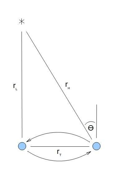

I'd like to submit one particular geometric solution in as simple manner as possible:
[tex]\textrm{aberration} = \Theta = tan(\frac{\textrm{r}_{\textrm{T}} \times (\hat{\textrm{r}_{\textrm{H}}} \cdot \hat{\textrm{o}_{\textrm{N}}})}{\textrm{r}_{\textrm{L}}})[/tex]
The vector ##\textrm{r}_{\textrm{T}}## is the transverse displacement of the observer from the point of photon emission.
The vector ##\textrm{r}_{\textrm{L}}## is the longitudinal displacement of the observer from the star in the same inertial system as the star.
The vector ##\textrm{r}_{\textrm{H}}## is the displacement of the observer from the point of photon emission. It represents the ray of the photon.
The unit vector ##\hat{\textrm{r}_{\textrm{H}}}## is ##\textrm{r}_{\textrm{H}}## normalized to have length 1.
The unit vector ##\hat{\textrm{o}_{\textrm{N}}}## is normal to the plane containing the Earth's orbit.
Crossing ##\textrm{r}_{\textrm{T}}## with the other terms should give the correct adjustment for the angle of the star with respect to the orbital pole of the Earth (where aberration is maximum).

Since an Earth-based observer will have a non-inertial relation to either the Sun or the star, the total of all motions needs to be summed during the time period that the photon was in flight. That will allow us to determine, geometrically, what the trajectory vector is for the impinging photon. Fortunately that's not terribly complicated, as I reported earlier
[tex]\Delta \textrm{r} = \int_{t_e}^{t_a} v(t) \ dt[/tex]
[itex]t_e[/itex] is the time that the photon was emitted
[itex]t_a[/itex] is the time that the photon was absorbed by the observer
v(t) is the relative velocity between the point of emission and the observer at time t
Then
[itex]\textrm{r}_\textrm{H} = \textrm{r}_\textrm{L} - \Delta \textrm{r} \ \ \ \ \ \ [/itex] [itex]\textrm{r}_\textrm{T} = \textrm{r}_\textrm{L} \times (\textrm{r}_\textrm{L} + \Delta \textrm{r})[/itex]
  • #53
Then
What theory of aberration is this? In SR, it is only based on the Lorentz transform. Instantaneously colocated inertial frames are all that is required for either an observer with acceleration or a source with acceleration (if you choose to involve the source frame at all - which is unnecessary and complicates things - but is not wrong). Past motion is irrelevant. There is no need for any integration.

  • #55
PhilDSP said:
So far this has purely been classical - non-relativistic, as it hasn't invoked the Lorentz transform. I believe the OP is interested in the numeric differences between the two, I certainly am.
Past motion is irrelevant for any single observation. For 2 or more different observations it would also be irrelevant if the velocity was constant over the period that those observations were made. The integration is one means of making the different observations compatible.
Where do you get that? From the very first post, this as been about stellar aberration in the context of SR.
The references in Histspec's #5 cover all the issues in this thread and more. In some sense, all after that is redundant.

  • #59
mfb said:
It is not. A moving star (relative to our sun) won't appear where it currently is, but this is not called aberration
So, the argument boils down to the fact that the aberration "is not called aberration"? A ray of light coming from a (distant) source is no longer aberrated as a function of the relative speed between the source and the receiver?
- it is just the time delay, the star had some years (or much more) time to move forward between the emission of light and our detection.
While the ray of light covers the distance star-Earth [itex]ct[/itex], the star has moved by [itex]vt[/itex] , where [itex]v[/itex] is the relative speed between the star and Earth. This results into an aberration of [itex]\tan \theta'=\frac{vt}{ct}=\frac{v}{c}[/itex]. Is this no longer called aberration?
We are discussing:
- whether the ray of light has a different angle in the frame of the emitter vs. the frame of the receiver, i.e. whether the well known phenomenon known as aberration of light is present
-whether or not changes in the speed of the star can be perceived as changes in the aberration angle.
Can you put this prose in math form, please? I asked this before, I am really interested in seeing the mathematical explanation.
Sure.
HM Cancri is a binary system where the white dwarfs orbit each other with velocities above .1% c, but they always appear at the same position in the sky.For even higher speeds, this picture for example. The source of a relativistic jet and the relativistic jet appear directly next to each other.
This may have a simple mathematical explanation, the variation in the velocity of the two stars may produce a variation in the aberration angle that is below the current measurement capabilities. Again, I would welcome a complete mathematical treatment, could you do this?
See the first part of this post. The effects of special relativity get split in different effects, a constant relative velocity between star and sun is not included in the aberration.
Can you explain this in mathematical terms? Stating it , even repeatedly, does not constitute a convincing argument. As a matter of fact, this is also the request of the thread originator.
  • #60
It boils down that you use a definition of aberration no one else does, I think. And one that fails as soon as the motion is not uniform any more.
This is obvious but we are not discussing the trivial fact that the star has moved between the time the ray of light was emitted and the time the ray arrived on Earth, we are discussing:
But that is exactly the (only) effect a relative velocity between star and sun has.
How do you compare angles and directions in frames with a relative motion?
Certainly not, see the binary stars.
Just view everything in the frame of the sun and there is absolutely no reason to expect any aberration effect (and nothing to calculate). Light travels in a straight line and does not care about the velocity of the emitter.
For the moving star, the direction it has to emit light to hit our Earth will be different the point where the star sees our earth, this is the same effect of the time delay just seen from the other direction.
No. A .1% motion of the objects in the sky (corresponding to their .1% c velocity) would be plain obvious to every observer. See above, there is no mathematical treatment needed for a straight line.
Reducing a physical problem to one that can be solved without any calculation is one of the most convincing arguments I know.
  • #61
So, according to you, [itex]tan \theta'=\frac{v}{c}[/itex] is no longer a valid expression for aberration if [itex]v=v(t)[/itex]?
I am starting to see your problem, this is not about "comparing angles". This is not about "frameS" , it is about ONE frame, the Earth (lab) frame and ONE angle (variable in time), the angle [itex]\theta'(t)=arctan \frac{v(t)}{c}[/itex].
Can you provide the mathematical analysis? This is the third time I am asking for it.
But the binary stars (and other stars as well) MOVE wrt. the Sun. Even worse, they MOVE wrt. the Earth observer.
