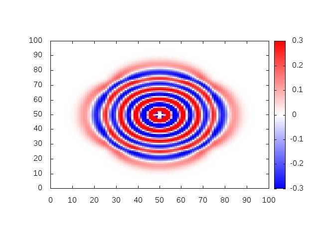

hi all,
i have wrote codes for 2d fdtd in different permittivity (epsilon). in this code, cell size is 200 x 200, start with eps=1 from center, and different permittivity started at boundary (i1,i2) = (25,75) = (j1,j2), epsilon = 2. the problem is, when the wave propagates and approach (i1,i2) = (25,75) = (j1,j2), i have detected some reflections happened to the wave at timesteps, n after 50, the reflections become obvious...i just wondering, why is that happened. i attached here the animation of the wave and my codes. i really have no idea how to solve this problem.

thank you for the reply. i just found out the problem caused by impedance mismatch. it is happened when i use different epsilon. wave impedance inversely proportional to the square of epsilon. So epsilon =1 wave impedance value is 1.414 times greater than epsilon= 2. If there is any impedance mismatch between the two layers it will create reflection. then, another problem, i found the cause of problem, but have no idea how to correct impedance mismatch in my simulation. do you have any idea?
