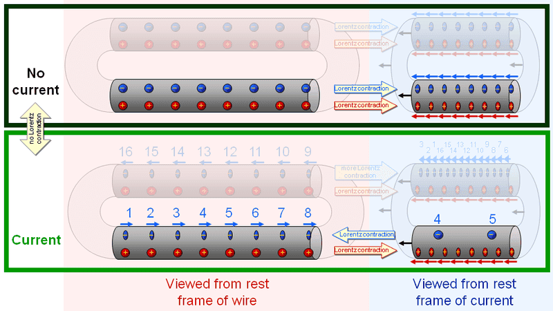

We thus start with, I think, an insulated wire containing a number of electrons N and an equal number of protons N.
I think that the following situation sketch is correct:
In the wire's rest frame:
- length contraction can play no role at all
- a magnetic field is observed
In any inertial moving frame:
- length contraction plays a role in predicting non-zero electric fields
- a magnetic field is observed that can't be transformed away
Is that correct?
Such a magnetic field looks reasonably "absolute" to me.
Harald
Why would the length contraction play a role in predicting non-zero fields when the number of positive charge and negative charges are equal?
In any case, does not the relative velocity between the charges pay a role here?
It is as if both relative velocity between charges and relative velocity between the the charges and the observer both collude in determining whether or not non-zero fields are observed.
I cannot simply call that "length contraction". Like another had stated, it is "length contraction plus something else".
Also, what if we inverted things and called the protons the "current" and the electrons the "wire"? In this case, the magnetic field would be seen as being produced by the positive charges. In contrast, the negative charges would not be seen as responsible for the magnetic field. The electron frame would be the "rest" frame of the wire. Would then we say that there exists zero electric field outside the wire from the "rest" frame of the electrons? And if we would move to the proton frame, now regarded as the "rest" frame of the current, would we then say that there is a non-zero electric field outside the wire?
This begs the question, "Could the problem be interpreted such that there is ALWAYS a non-zero electric field outside the wire, depending on what one regards as being 'current'?" Obviously there is a gap in reasoning going on here. So what's up with that?
Alternatively, if you consider the fact that "ionic current" or "positive charge" current can be just as guilty in producing magnetic fields as the electron current, one would realize that for the case of a neutral wire, different Lorentz transformations do not lead to differences in the magnetic flux. The magnetic field produced by a + charge is equal and opposite of that produced by a - charge if their movements are the same. So the magnetic flux produced by the neutral wire should be frame invariant. What changes is the magnetic flux intensity (a.k.a. magnetic flux density) and corresponding area of integration (an area which is itself subject to Lorentz transformations). This is same as with the electric flux; the Lorentz transformation leaves it unaltered (with the electric field intensity (a.k.a. electric flux density) and corresponding integration being subject to exact same transformation as that of their magnetic counterparts).
Now, if we the consider the case where have only an electron beam (no positive charges), we must realize that a charge in a co-moving frame same as that of another charge, is not going to experience a magnetic force from that other charge, but only an electrostatic force. This is the same electrostatic force that one would expect if you simply had the two charges at so-called rest, separated by the same distance (correcting for the Lorentz transformation of course). However, if you have the charges moving at different speeds, there is a relative velocity between them. Only then can you say that they interact magnetically.
It appears it is the relative velocity (or lack thereof in other cases) that determines whether or not there is magnetic interaction between particles in a system.
Of course, you can predict that two electrons co-moving relative to an external observer will have a magnetic field around them, but that magnetic field is not something that the charges interact with, because in their frame, that field simply does NOT exist. So as long as nothing in the frame of the external observer interacts with those particles, the magnetic field as seen from the point of view of the external observer may as well not exist, for lack of physical significance.

  • #49
In any case, does not the relative velocity between the charges pay a role here? [..]
In a frame in which the charges are moving at different velocities, the charge distribution may be inhomogeneous. However I suppose that that is not the point of this discussion: I merely noticed that for such a case length contraction may play a role in what is not under discussion here. My point is that according to my analysis, magnetic fields can in general not be transformed away.
Also, what if we inverted things and called the protons the "current" and the electrons the "wire"? In this case, the magnetic field would be seen as being produced by the positive charges. [...]
Sorry I can't follow that; a magnetic field appears as the result of whatever moving charges - no matter if those are the protons or electrons or both.
A non-zero (at least, non negligible) electric field can be measured.
For a current-free wire, indeed. That isn't an issue.
Now, if we the consider the case where have only an electron beam (no positive charges), we must realize that a charge in a co-moving frame same as that of another charge, is not going to experience a magnetic force from that other charge, but only an electrostatic force. This is the same electrostatic force that one would expect if you simply had the two charges at so-called rest, separated by the same distance (correcting for the Lorentz transformation of course). However, if you have the charges moving at different speeds, there is a relative velocity between them. Only then can you say that they interact magnetically. [..]
The Lorentz transformation does the same as the introduction of a magnetic force; that realisation is the basis for this kind of discussions. However, as I illustrated, more insight can be obtained if one doesn't limit one's thinking to linear cases and instead considers a more basic magnet such a made with a single wire loop.
Your argument doesn't apply to more general cases as I illustrated. Magnetic and electric fields are relative in the way that length contraction and simultaneity are relative; it doesn't mean that one of the concepts should be discarded.

  • #52
Right, length contraction is relative.
The problem is:
* I can have the positive charge have a greater length contraction in the frame of the negative charge.
* I can have the negative charge have a greater length contraction in the frame of the positive charge.
Following the claims of DaleSpam's comments, this would mean that the wire can appear to have net positive charge or a net negative charge, depending on the frame of reference. There is also a frame in which the length contractions of the positive and negative charges match. I suppose that is when the electric-field outside the wire disappears.
Now that I think about it terms of length contraction, the changes of the electric field with respect to the frame given is NOT linear because the equations for length contraction do not have constant derivative with respect to relative velocity with the observer. Therefore, the LT would result in different change "factors" for the electric field of the electrons and the electric field of the protons in the case when there is current.

  • #54
The idea that the electric field intensity of each charge being variant with respect to the observer isn't strange to me.
What's strange is the idea that steady-state (read: DC) current should somehow be uniform through out the wire when the protons and electrons clearly cannot be subject to the same length contraction.
kmarinas86 said:
DaleSpam said:
kmarinas86 said:
Let's keep this REALLY simple. Assuming that the wire is neutral (no net charge) and that the wire is 1 meter long and that I have a length contraction of electrons, why should I get from that a uniform charge distribution when the electrons are drifting through wire (current)?
In the steady state the four-current (density) is uniform and constant in the lab frame, therefore it is uniform and constant in the test-charge frame also.
kmarinas86 said:
I would TOTALLY expect an un-uniform distribution, assuming length contraction applies to the bulk flow of electrons.
Why? Why do you expect a gap of any kind in the steady state?
kmarinas86 said:
I STILL don't have an answer to my question as to what do the electrons actually length contract towards.
Length contraction occurs, as always, in the direction of motion. The word "towards" doesn't make any sense in this context. The word "towards" implies something changing over time. Length contraction does not change over time in an inertial frame.

Attached to the bottom of this post is a diagram to help explain things. As was mentioned earlier in this thread, one way to approach the problem is to consider it a variant of the ladder paradox, and consider the different definitions of simultaneity.
But my approach here considers length contraction only. And I am going to consider a complete circuit: not just a single wire with a left-to-right electron flow, but also a return wire with a right-to-left flow. Apart from the ends of the wires, we keep the two wires far apart so they have negligible influence on each other. The diagram is a highly idealised simplification, considering just 16 electrons in the circuit. The ends of the wires should be in contact with each other but I've drawn them as separated to keep the diagram simple.
The top left part of the diagram shows the wires with no current flowing, in the rest-frame of the wires. 16 electrons equally spread out along the wire.
The top right part of the diagram again shows the wires with no current flowing, but now in a frame moving at the velocity that electrons would flow in the bottom wire if the current were on. We see length contraction as indicated by the yellow arrows. I'm assuming a Lorentz factor γ=2. So far so good.
The two bottom diagrams now show what happens when the current is flowing.
In the bottom left diagram, as we are told the wires remain electrically neutral, there must still be 16 electrons in the wires. There's no reason for the electrons to bunch together anywhere, they will remain spread out around the whole circuit as shown.
Finally, let's look at the bottom right diagram, which I think some people are having difficulty to imagine. We already know what happens to the red positive ions, their separation contracts just as before. The electrons in the lower wire are now stationary, so their separation must be larger than the bottom left diagram as shown. On the other hand, the electrons in the upper wire are moving faster than in bottom left diagram, so their separation must be less than in bottom left diagram. No electrons have escaped so the total number of electrons in circuit must still be 16. But now there are fewer electrons in the lower wire and more in the upper wire. So the lower wire has a positive charge and the upper wire has a negative charge.

  • #58
I think that using the return wire to prove a point is cheating. It does nothing for the original scenario without a return wire.
The ladder paradox also has some asymmetries that seem to be missing in your example:
Figure 4: Scenario in the garage frame: a length contracted ladder entering and exiting the garage
Figure 5: Scenario in the ladder frame: a length contracted garage passing over the ladder
The two frames do not see the same number of rungs inside the garage in each case.
If we assumed that the protons were represented as tiles on the garage floor, the garage as the wire, and the ladder as the electron current in and out of the wire, then clearly the charge inside the boundary of the garage is not invariant.
However, considering that the electric field intensity increases by the same amount that the boundary of the garage in the LT frame is length contracted, this would keep the electric flux around that boundary of the garage a constant.
  • #59
Well it has the advantage of charge conservation in a closed system, which doesn't apply to an open-ended wire.
Sorry, somehow the image attachment to my post failed to upload correctly. I have now re-uploaded it and added it to that message.
If you ignore my return wire and concentrated on my lower wire only, it seems to me that my diagram agrees with your ladder diagram, so I haven't grasped what your problem is.
  • #60
The problem is that we are talking about a single current and the fact that charge has to be conserved between frames for that single current.
There can be charge outside the wire ends (say at the ends of a capacitor or what not).
  • #61
But both my example (restricted to the highlighted bottom wire) and the ladder example (restricted to the interior of the garage) show that this isn't true.
In my example the number of electrons decreases from 8 to 2. In the ladder example, the number of rungs within the garage decreases from more than 11 to about 7.
(Note: on a technicality "conserved between frames" should really be described as "invariant". "Conservation" refers to lack of change over time within a single frame.)
