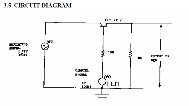

I found a pdf file about a laboratory excercise in PAM (and demodulation).
I think it's the one I am looking for.
The title is:
LAB - 3
PULSE AMPLITUDE MODULATION & DEMODULATION
and the circuit diagram is:
My problem this time is the hardware requirements.
I don't know what is the meaning of AFO, CRO and CPS.
Can you pls tell me what are these things? So that I can go to a hardware shop immediately :)

From what I saw in the PAM links, the output is a series of rectangular pulses, with different amplitude rectangular pulses representing the encoded (modulated) information.
The schematic you posted looks to be an ON-OFF modulation of a sinusoidal source. From the title of the schematic/lab, it appears to be a different interpretation of PAM. Do you think that is what your lab is about?
Yes, that's the PAM I exactly need.
You mean the circuit diagram I posted is a different interpretation of PAM. I see.
I'll try using the DAC you suggested then.
Thanks :)
