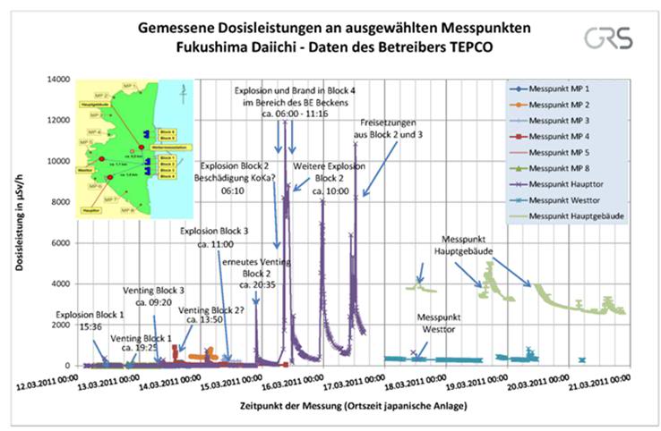

I don't read German very well, but these are the radiation spikes measured and it looks like the largest measured spike on site, so far had something to do with an explosion and fire in Block 4, and that since that time, background (baseline) radiation levels have been steadily climbing:
[URL]http://www.spiegel.de/images/image-192946-galleryV9-pakh.jpg[/URL]

For the chart readings - it would be interesting to see if the spikes also co-relate to the dousing of the SFP and steam release?

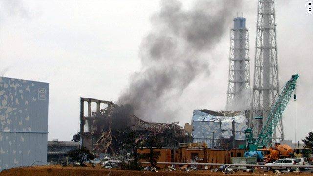

The problem is that we don't know the exact status of the SFP in any of the units, and until we see pictures, or someone publishes a reliable measure of the depth of water in the pools.
We also don't know the exact status of the fuel and cores of units 1, 2, and 3. For now, in the absence of direct evidence, we can only look from the outside of the damaged reactor buildings at the damage and ask - what would have caused that? Well - we did see explosions, fires, smoke or dust, and steam. The steam is obviously coming from boiled water, either in containment, SFP or both.
It may be the explosion of the containment of Unit 3 did most of the damage to Unit 4. Interestingly, the framework (girders and spans) of Unit 4 is still intact, although the panels got blown off. That indicates that if there was an explosion in Unit 4 upper containment, it wasn't so bad as to take out the framework. The panels are likely held on by metal screws.
Previously, there is a mention of 'melted' framework. I don't believe it is melted, but bulked or twisted (torsions), with large strains in some cases.
(One of my summer jobs during university was ironwork. I used to build metal buildings, and did the framework from floor to peak, and also did the sheet metal. I miss that!)
The smoke from Unit 4 could be burning oil or hyrdaulic fluid. It's not white, so it's probably not steam.
Each unit presents similarities, but is also a separate problem in and of itself.

This was noted on another forum but if you look a bit closer at the various photos that have been circling you can quite easily notice that framework and general construction of the containment buildings upper floor roof & walls of reactor building 1-3 is made of iron and concrete whereas the containment building of reactor building 4 seems to be made out of more heavy materials.
