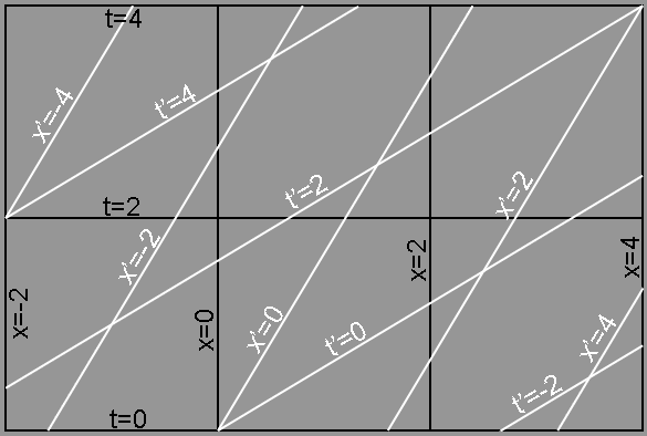

Sure, you didn't use the full Lorentz transform, just bits and pieces cobbled together.
Look at the attached diagram which is simply the Lorentz transform for an unprimed "rest" frame (black) and a primed frame (white) moving with relative v=0.6c (c=1). If the back end of a proper-length 2 rod at rest in the unprimed frame follows the worldline x=0 then the front end follows the worldline x=2. If the back end of a proper-length 2 rod at rest in the primed frame follows the worldline x'=0 then the front end follows the worldline x'=2.
Note that, starting from the origin, the t=0 line intersects the x'=2 line before the x=2 line. The primed rod is shorter than the unprimed rod (in the primed frame).
Note that, starting from the origin, the t'=0 line intersects the x=2 line before the x'=2 line. The unprimed rod is shorter than the primed rod (in the unprimed frame).
There is no contradiction, they are talking about two different sets of events.

granpa said:
you believe that a can be shorter than b while b is at the same time shorter than a?
When you say "a is shorter than b" you must specify the frame in which measurements are being made. Until you do, the statement is meaningless. According to frame b, frame a lengths are "contracted"; according to frame a, frame b lengths are. No problem.

If you multiply every vector in DaleSpam's diagram with
[tex]\gamma\begin{pmatrix}1 && -v\\-v && 1\end{pmatrix}[/tex]
The diagram will turn into its mirror image with black and white swapped, i.e. the white lines will look the way the black lines do now, and the black lines will look like the white lines do now except they'll be tilted the other way.
It makes no sense to say that one of these diagrams represents reality and that the other doesn't.
granpa said:
thats obviously true but what does that have to do with what i said?
It directly addresses your concerns about both being real (a is shorter than b and b is shorter than a).
This is correct. Because of that, some people draw both frames at the same angle (i.e. from the perspective of a "midpoint" observer) to emphasize the symmetry. This was a drawing that I did rather early on in my understanding of SR, so I wasn't skilled enough at the time to do such a symmetric diagram. But even without making the symmetry obvious you can still see how each frame sees the other as length contracted and time dilated.
