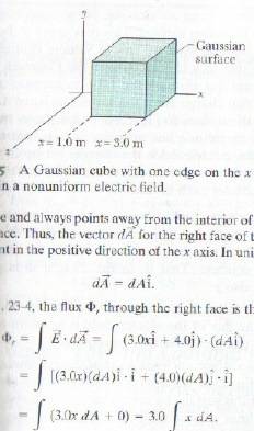

In summary, according to the attached picture, the electric field is constant over the right side of the cube, so no integration is necessary. The only component of the field that contributes to the flux through a side is the component perpendicular to that side.

I'm having troubles understanding what's going on here, with the integration. Here is the integral through the right face of the cube.

Given: A nonuniform electric field given by E = 3.0xi + 3.0j pierces the gaussian cube. x = 3.0m.
Flux = S (E).(dA) = S (3.0xi + 4.0j).(dAi)
= S [(3.0x)(dA)i.i + (4.0)(dA)j.i] //whats goin on here? are they just distrubting the dA? Why are they allowed to sperate the vector i from dA?
= S (3.0x dA + 0) = 3.0 S x dA //why is i now 0? wouldn't it be cos(0) = 1? or how do u figure out where the electric field is pointing with the equation: 3.0xi + 4.0j.
= 3.0 S (3.0)dA = 9.0 S dA.
How do you insert symbolic symbols so my future posts won't looks this messy? Thanks. Picture is attached.

According to your attachment, the "right face" of the cube is the plane x= 3.0 and the (outward) unit normal is i so the dA= dydz i. Therefore
(3.0xi+ 4.0j). dA= 3.0x dydz= 3.0 x dA where dA= dydz.
i did not become "0" the dot product of two vectors is a scalar (number).
(3.0xi).(i)= 3.0x, of course.
Thanks for the responce but I'm still confused... how do you go from, dA = dydz i.
then you said dA = 3.0x
dydz = 3.0 x dA...You didn't take the derivative of anything did you?
^is this the variable x or meaning multiplcation?
Halls, simply did the dot product, the result was 3x dA, then if you look at the picture x = 3, so 9*A, should be the solution.
The only component of the field that contributes to the flux through a side is the component perpendicular to that side. For the right side of the cube, that perpendicular direction is the [itex]\hat i [/itex] direction. The component of the field in that direction is [itex]3.0 x \hat i[/itex]; at x = 3 m, that component equals [itex]9.0 \hat i[/itex] (in units of N/C). Since the field is constant over the area of the right side, no integration is needed, just flux = E times Area.
ohhh i think i finally get it... so because the y component of the electric field doesn't matter (4.0j), you can just discard it and only worry about the 3.0xi. and because x = 3, you end up with 9.0i. So really is i just telling the direction of the vector? you can just discard it? I'm still confused on one issue though. [itex] \zeta [(3.0x)(dA)\hat i \bullet \hat i][/itex] You said you took the dot product, if A is pointing to the right, and also the electric field is point right, wouldn't that be cos(0) = 1? how did they get 0? [itex] \zeta [(3.0x)(dA) + 0][/itex] Sorry I'm really really rusty on vectors! :bugeye: that zeta is suppose to be an integral sign, i can't find the integral on the latex guide.
It looks like you don't know this:
[tex] \vec{i} \cdot \vec{i} = \vec{j} \cdot \vec{j} = \vec{k} \cdot \vec{k} = 1 [/tex]
[tex] \vec{i} \cdot \vec{j} = \vec{j} \cdot \vec{k} = \vec{i} \cdot \vec{k} = 0 [/tex]
Ah and the integral is
[tex] \int [/tex]
ahhh! thanks so much, I had no idea that property even existed. Damn luckly I'm not going to be a mechanical engineeer.
