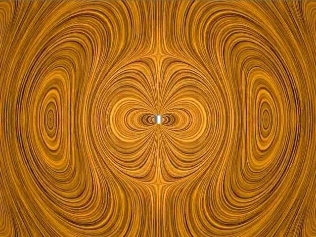

A periodically accelerating observer will experience electromagnetic waves, if stationary charges exist nearby.
In other words, stationary charges emit electromagnetic waves, as far as this observer is concerned!
For example an observer is going up and down at each pixel of the following picture, instead of electrons going up and down in the dipole. Also there is no dipole, only a fixed stationary charge in the centre.
Here is a video of the waves experienced by observers at each pixel.
http://web.mit.edu/~sdavies/MacData/afs.course.lockers/8/8.901/2007/TuesdayFeb20/graphics/SmPointDipole_640.mpg

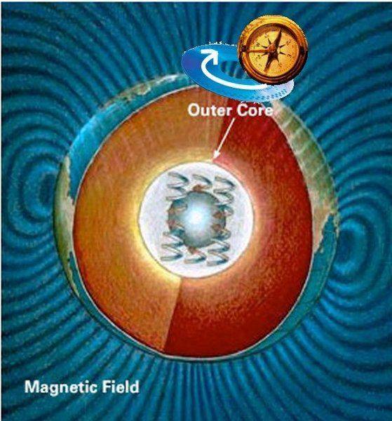

So maybe if you go to the magnetic north pole of the earth, and put a campus on the edge of a rotating disk, then at the right rate of rotation the campus will register no magnetic force!
Or maybe not. Maybe I have the maths wrong, magnetic fields do not superimpose linearly, right? Can someone provide the full maths of electromagnetic forces between moving and accelerating point charges please, the full equations for the forces that is, anyone?
If the conclusion is correct, ie that superposition of magnetic fields due to different rotations of the iron in the Earth's core is LINEAR, then how fast does the disk have to rotate, in order for the campus to register no magnetic field? (diagram not to scale of course, magnetic field can be assumed constant in the vicinity of the campus and disk).

Be aware, both the oscillating and rotating frames that you are talking about are non-inertial. So you will have to add all sorts of "correction" terms and ficticious forces in order to use them.

I don't know enough about electromagmetism in non-inertial reference frames to answer that question. Basically, in non-inertial coordinate systems you have to introduce "ficticious forces" to make mechanics work. I would assume that you would have to introduce ficticious charges or fields or currents or something similar to get EM to work, but I don't really know.
That said, my gut feeling is that you could not neglect relativistic effects even at low angular velocities. EM forces are so strong that relativistic effects can become important when changing between inertial reference frames even for velocities on the order of 1 m/s.

Sorry to interrupt but if you could trace the field from an oscillating electron, would it be in the form of rapidly expanding and alternating tori as the first cross section suggests?
Not necessarily, depends how the electron oscillates, I guess the cross section is exactly as shown for a sinusoidal oscillation, like in a dipole.
