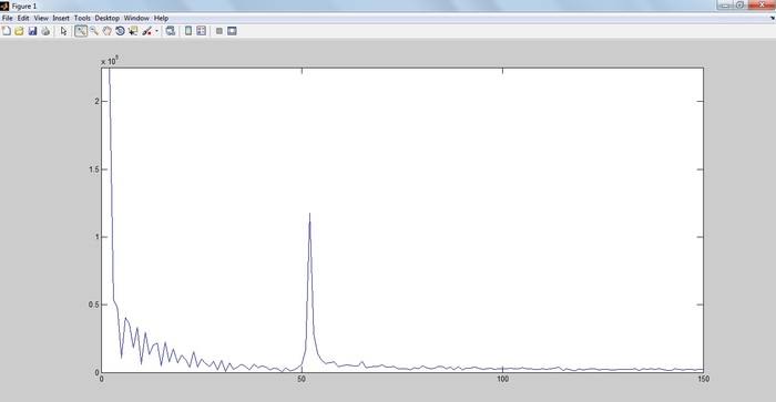

I mean, okay, i copied the signal in MATLAB and plotted it, it comes out as shown in the figure. I have to design two filters, band stop and a high pass filter to attenuate the noise in the signal.
I know that the bandstop specifications include first/second pass/stop band frequencies, attenuation gain etc etc, but how do i go about calculating them??

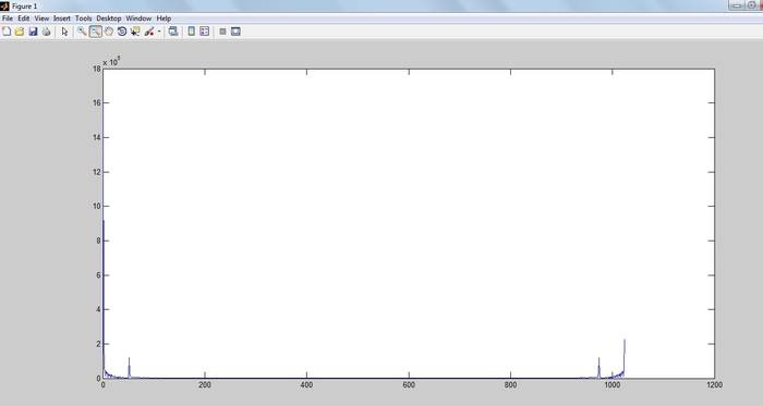

As for the my work, I did the following, since the sample includes 150, 000 samples and we don't really need all of them. Since the sampling freq is 1000Hz, we can take up any number of samples above that. I took 1024 samples and took the fft of the sample, and plotted the abs value graph and got the signal in frequency domain and now the powerline is clearly visible at 50Hz.
the graphs:
so the passband and stopband frequencies are around 50Hz as in these graphs?

Thanks for your help anyways! I am surprised, you thought that the second diagram was a partial filtered graph of the first. Its an ideal ECG signal!
