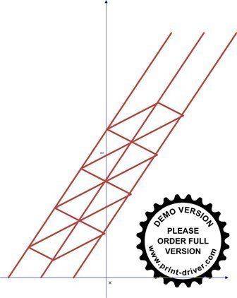

Hello,
The below images show O's accelerating motion with respect to R. As speed changes desynchronization becomes bigger with respect to R.
Please, look at first frame of below image. It shows desynchronization of clocks when frame is in motion. But, it is with respect to R.
When we transform to first frame, as below image shows there is no longer desynchronization with respect to O. But, second frame is desynchronized with respect to O.
But, again we transform to second frame. there is no longer desynchronization with respect to O. But, first frame is desynchronized with respect to O.
So, desynchronization is only there when we see other frame. Our own frame cannot have desynchronization with respect to itself.
So, as I understand constant speed of frame would not create desynchronization, and changing in frame (acceleration) also would not create desynchronization.
Can you explain me how acceleration can create desynchronization with respect to O?
  • #37
John232 said:
I don't recal ever hearing that clocks that accelerated together at the same rate would ever no longer be synchronized.
In an inertial frame this is correct. Two clocks which are initially synchronized and share the same speed profile will remain synchronized, but only in that inertial frame.
In other inertial frames or in non inertial frames they will not be synchronized. O's frame is non inertial.

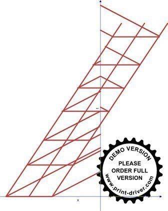

There is other doubt too.
second image of post #36 says clocks is synchronized with respect to O, but not for R. For R clock A is ahead of clock B, because signal reaches lately to B with respect to R because of direction of motion.
Suppose, that train is coming from far left of R, it passes R and goes far right with constant velocity. So below image show how clocks becomes desync with respect to R. It also tells train coming from left and goes right not make changes in desync. A is always ahead of B with respect to R during whole journey.
But, wait if we think how R sees clocks during whole journey. Below image show that
There is matter that train coming from left and goes to right. Coming from left tells R that clock B is ahead of A, and going right tells R that clock A is ahead of B.
Look, at the point where R and O is on perpendicular line of train path way. This is the point where R thinks both clock is synchronized.
From my understanding, first image shows that "R thinks that clocks would be desynchronized like this with respect to O". Neither for R the clocks would be desynchronized like this, nor for O.
What I understand is clocks is perfectly synchronized for O and, clocks is desyhnchonized with respect to R as showed in second image.
Can anyone shade some light on this?
Thanks
I fail to see how that is true without an explanation. For instance, how does the relation of the distance of two objects make them observered from rest as measuring time differently when they have accelerated the same amount for the same duration? I think the proof in the pudding here would be that if you considered each object separately you would find that they both expereince the same amount of time dialation, but if you considered them together or linked to an action they would be seen to experience different amounts of time dialation. So, then why would an object require different amounts of spacetime dilation if it was seen to travel at the same speed of another object in order to measure the same speed for light? It would make it seem that the origanal answer of the amount of spacetime dilation occurred for each object would be false unless you considered your own relation to the object. Then answers that considered your relation to the object would not be interchangeable with answers that didn't consider your relation to the object, since they would give different values. Then if the object is traveling with a velocity then would the amount of spacetime dilation that occurred change as it moved to a different location? Then the whole thing falls apart, none of the results would give the same speed of light or the same amount of time dilation if it was considered to be X units away from something else, and that affect the outcome of the amount of spacetime dilation that occured.
For each velocity, there could only exist one distortion of spacetime that would conclude that there is the same value for the speed of light. For instance, two people traveling together on a train couldn't be seen to measure time differently because then they would each have different values of the speed of light. Their location as being in the front or back of the train doesn't affect how they can make that measurement. The basis of SR is that the speed of light is constant in all frames. I think clocks should only be checked if they are synchronized using an entanglement experiment, something Einstein never would have done because nothing was supposed to travel faster than the speed of light at the time.

Certainly, it follows directly from the Lorentz transform. Let's analyze the scenario from the OP where at t=0 in the original frame A, B, and M all accelerate instantaneously up to v = .6c and furthermore let's use units where c=1 and where the distance from M to A and from M to B is 1 in the original frame.
So, in R's frame the worldline of A, O, and B are:
[tex]r_d=\left(t,x=\begin{cases}
d & \mbox{if } t \lt 0 \\
0.6 t+d & \mbox{if } t \ge 0
\end{cases}
,0,0\right)[/tex]
where d=-1 for A, d=0 for O, and d=1 for B.
As per the OP, the clocks are initially synchronized in R's frame such that at t=0 they all read 0. So, we can calculate the time displayed on each clock, τ, using the spacetime interval. Solving for t we get:
[tex]t=\begin{cases}
\tau & \mbox{if } \tau \lt 0 \\
1.25 \tau & \mbox{if } \tau \ge 0
\end{cases}[/tex]
Substituting into the above we get:
[tex]r_d=\left(
t=\begin{cases}
\end{cases},
x=\begin{cases}
d & \mbox{if } \tau \lt 0 \\
0.75 \tau+d & \mbox{if } \tau \ge 0
\end{cases}
,0,0\right)[/tex]
Noting that τ does not depend on d in this frame we see immediately that the clocks remain synchronized in R's frame.
Now, boosting to the primed frame where O is at rest for τ=t>0, we obtain.
[tex]r'_d=\left(
t'=\begin{cases}
1.25 \tau - 0.75 d & \mbox{if } \tau \lt 0 \\
\tau - 0.75 d & \mbox{if } \tau \ge 0
\end{cases},
x'=\begin{cases}
1.25 d - 0.75 \tau & \mbox{if } \tau \lt 0 \\
1.25 d & \mbox{if } \tau \ge 0
\end{cases}
,0,0\right)[/tex]
Noting that τ does depend on d in this frame we see immediately that the clocks are desynchronized in O's frame. If there is some step that you do not follow then please ask for clarification. But it is quite clear the the clocks remain synchronized in the unprimed frame and are not synchronized in the primed frame.

  • #48
mananvpanchal said:
But I don't follow this. I have tried to get it, but I don't succeed. That's fine, don't worry about it.
So, using the matrix form of the Lorentz transform we have:

  • #49
mananvpanchal said:
Please, shade some light on my post #36 and #39. Please, tell me what is wrong with my understanding.
If you go back to your #36 and #39, you can see that you have identified some events on A and B which are identified as being simultaneous for O.
What you have not done is indicate what the clocks at A and B read at those events. However, if you look at the length of the line from the bend, when the clocks all read 0, to the events in question you will see that they are different lengths.
Therefore A and B will not read the same at those events. They will therefore be desynchronized according to O.

As we get the equation below
DaleSpam said:
[tex]r'_d=\left(
t'=\begin{cases}
\end{cases},
x'=\begin{cases}
\end{cases}
,0,0\right)[/tex]
We can see that [itex]t'=\tau - 0.75 d, \mbox{if } \tau \ge 0[/itex]. And we know that d=-1 for A, d=0 for O and d=1 for B then, we can get this
[itex]t'_a=\tau + 0.75,[/itex]
[itex]t'_o=\tau, [/itex]
[itex]t'_b=\tau - 0.75[/itex]
But suppose, train is going to opposite direction, then the equation cannot distinguish both [itex]t'[/itex]. We get same values for A and B for both direction, if A is ahead in one direction, A will be ahead in other direction too. The equations is depend on [itex]\tau[/itex], and [itex]\tau[/itex] is not depend on [itex]x[/itex]. [itex]\tau[/itex] is just time dilation, in whatever direction the train is going
But, there must be meaning of direction of motion.
What clock is ahead of other is matter of method used for reading, as mathal and I said before. But using anyone method, the result should be opposite if direction of motion is opposite. If A is ahead in one direction, then B must be ahead in opposite direction.
So, far We get only one reason for desynchronization is "length contraction".
The above image shows that train has length of l1 at start X, train accelerated to Y point, at that time length becomes l2. From now Y to Z train maintains its constant velocity, so now length remain same as l2. llxy, lrxy, llyz and lryz is distance traveled by front and end point of train.
We can easily see that ratio between llxy and lrxy is more than llyz and lryz.
So, as train maintains its constant velocity for longer time the desynchronization created by length contraction decreases.
If we guess that one way speed of light is not same in all direction then we have now another reason to explain desynchronization on frame change. Like, light takes more time to reach to observer in direction of motion and less time in opposite direction. But, in this idea direction of motion matters. If we change direction of motion A and B changes its state of desynchronization.
But, we cannot say one way speed of light is not same in all direction.
And we cannot say change in frame cannot affect synchronization.
May be anyone we have to pick.
  • #54
"with respect to O" described in post #36. Actually I have identified all events as being simultaneous for O.
Actually, I want to say with this three images that all events is simultaneous for O.
Ok, please look at second and third image.
In second image O is currently in first frame. Second frame is also O's frame, but second frame is future of O. O sees that all events in first frame is simultaneous for him. If somehow O could see second frame, O can conclude that in second frame events will not be simultaneous for him. Now, O changes his frame, if we want to look actual scenario, we have to transform from first frame to second frame. To show transformation I converted second image to third image. Now, please look at third image. Again O sees in second frame all events is simultaneous for him. If somehow O could see his first frame, O can conclude that events would not be simultaneous for him in first frame.
So, conclusion is if current frame is inertial then all events would be simultaneous for O. When frame is changed, some desynchronization occurs if this case happens. Suppose, O have fires pulses in both direction. O changes his frame in mean time before the pulses reach to the clock-mirror. In that case desynchronization created. But it will be for just that one pulse firing. Now, O again in inertial frame. Now O fires pulses, O feels clocks is synchronized again.
  • #55
