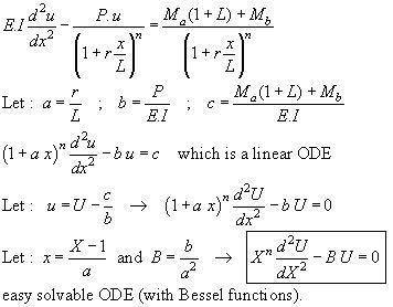

Hello,
I'd like to know how to solve the ODE shown in the attached file using Bessel functions
I will be very grateful!
