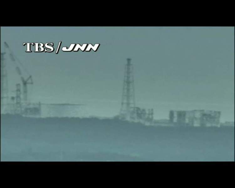

AntonL said:
Forgive me if this was done before, after having found the location of the camera by aligning the HV line tower with the left most stack and reactor unit 1 (https://www.physicsforums.com/showpost.php?p=3296107&postcount=6694") and the heading of the sight line being 36.04 degrees to the centre of unit 4 south wall, and taken that wall as 34 metres. We then can scale the photo of the explosion quite accurately (34 Cos 36.04 = 27.5)
As the building top is OP+55 metres making the stacks about 90 metres high from ground level.
The speed of the column rising is about 50 m/s or 180km/hour
I also added some further dimensions, showing that the roof sheets got carried up to around 150 metres above the roof top of the reactor buildings and tried to size the black object, the two white objects are about half the size.
[PLAIN]http://k.min.us/inBoDM.jpg[/QUOTE]
Thanks for this.
If that black object is is roof sheeting though, it must have something substantial attached to it, as it neither looks nor moves like heavy metal sheeting I have seen peel off roofs in high winds.
Those move more the way leaves do, twirling and shearing sideways. Like flying blades, not blocky objects.
I would expect metal sheeting lofted by this explosion to not come down anywhere near vertically. The crumpled sheeting seen on the reactor grounds on the other hand, does look like what happens to free flying metal sheeting, not something still attached to framing.

ElliotLake said:
Thanks for this.
Were the concrete shield plugs on top of the dryer-separator storage pool? Could they be those flying "blades"? Where are they stored when they are not in place, possibly in the NW corner?? (I should really look at that service floor NRC document with the weights and stuff at some point...)
PS: The big chunk leaves a trail of dust when falling, I think that's one reason I think it might be something like concrete.
Dust would seem to be to a concrete chunk that has been hurled 100s of meter in the air, like moss to a rolling stone. Could it be something hot, smoking? Several of the objects falling out of the cloud leave dust/smoke trails.
When unit #4 exploded, most of the roof's concrete (or some similar material) was apparently lifted as a unit, and then fell at an angle into the roof steelwork near the north wall. Part of it is still sticking out of the roof. The part that is below the roof can be glimpsed in this photo
http://www.flickr.com/photos/xtcbz/5705937712/in/set-72157626687253144
It is the dark grey "drape" in the background. As others have observed, the "groves" or "folds" visible on that thing are probably the impressions of metal roof panels that supported it.
Seems possible that some of the large objects that were lifted by the explosion of #3 may have been similar to this sheet.
