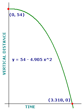

Wow thanks for that. Ok so this is what I've done now:
t = sqrt [ (2 * d_fallen) / g ]
t = sqrt [ (2 * 54) / 9.81 ]
t = sqrt [ 108 / 9.81]
t = sqrt 11.009
t = 3.318
d_horizontal = vt
v = s / t
v = 50 / 3.318
v = 15.069
Does this seem like the correct answer? Cos I only have one submission for this question, and I really don't want to get it wrong, I want to know how to answer questions like this! So does 15.069 ms^-1 seem about right? Or have I gone wrong somewhere in my calculations...
Approximation, estimation, generalization
if you're unsure about your answer, you can do one of two things to check it...
A) Solve it backwards using your answer.
B) Graph it. It's easy, really... just set X as the time variable and d_y as the y variable, and you should easily be able to see if your answer for time @ y=0 is correct...
Learn to love your TI-83, 83+, 86, 89... :approve:
ah thanks a lot i got the answer correct, much appreciated.
