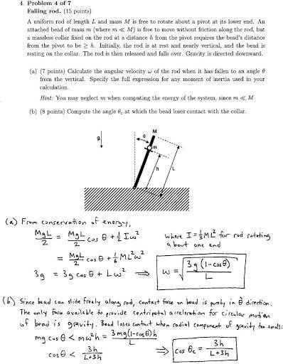

Conservation of Energy for a rotating Rod

Rotational Kinetic Energy = 1/2*I*w^2
I was just wondering if someone explain to me why the potential energy is MgL/2 ?
Is this not the same for the torque from gravity?
As the hint in a) states, you can neglect the mass m. And since the mass M is uniform, you can presume all its weight is in the center, hence MgL/2
Because the rod's center of mass is placed at L/2 over the ground.
Edit: oops, already answered :)
The rod is uniform. Where is its center of mass?
The torque from gravity about the pivot point depends upon the angle of the rod.
Edit: Already answered twice!
ok so then its just mgh with h = L/2 . that makes sense
then as it tips the hypotoneuse would be L/2, and the height would be this times the cos of theta.
thanks
