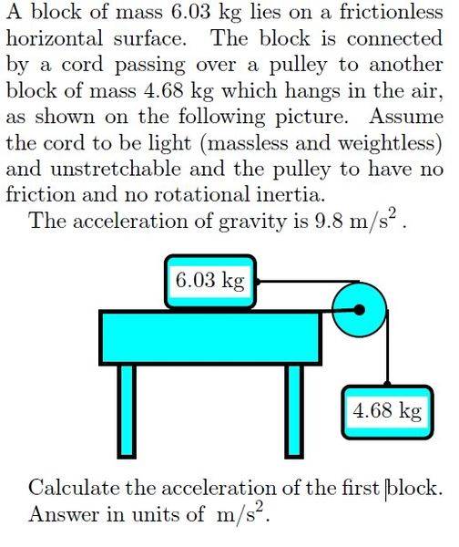

AHinkle
m1
[tex]\Sigma[/tex]Fy=N-m1g = 0
[tex]\Sigma[/tex]Fx=T=m1a
(Because there's no friction i see no opposing force to T)
m2
[tex]\Sigma[/tex]Fy=m2g-T=m2a
[tex]\Sigma[/tex]Fx=0
m2g-T=m2a
T=m1a
(m1+m2)a=m2g-T+T
I notice that the T's cancel when i add the equations together
so it becomes
(m1+m2)a=m2g
so...
a=(m2g)/(m1+m2)
so...
T=m1a
T=(m1) (m2g)/(m1+m2)
m1=6.03kg
m2=4.68kg
T=(6.03Kg)((4.68Kg)(9.8)/(6.03Kg+4.68Kg))
so...
T=25.8225N
T=m1a
25.8225N = (6.03Kg)a
a=4.2823 m/s2
did i do this right?
AHinkle said:
m2g-T=m2a
T=m1a
(m1+m2)a=m2g-T+T
so it becomes
(m1+m2)a=m2g
so...
a=(m2g)/(m1+m2)
You know, you could have just plugged the numbers in here and saved yourself some work. :smile:
a=4.2823 m/s2
'Looks right to me. :approve:
